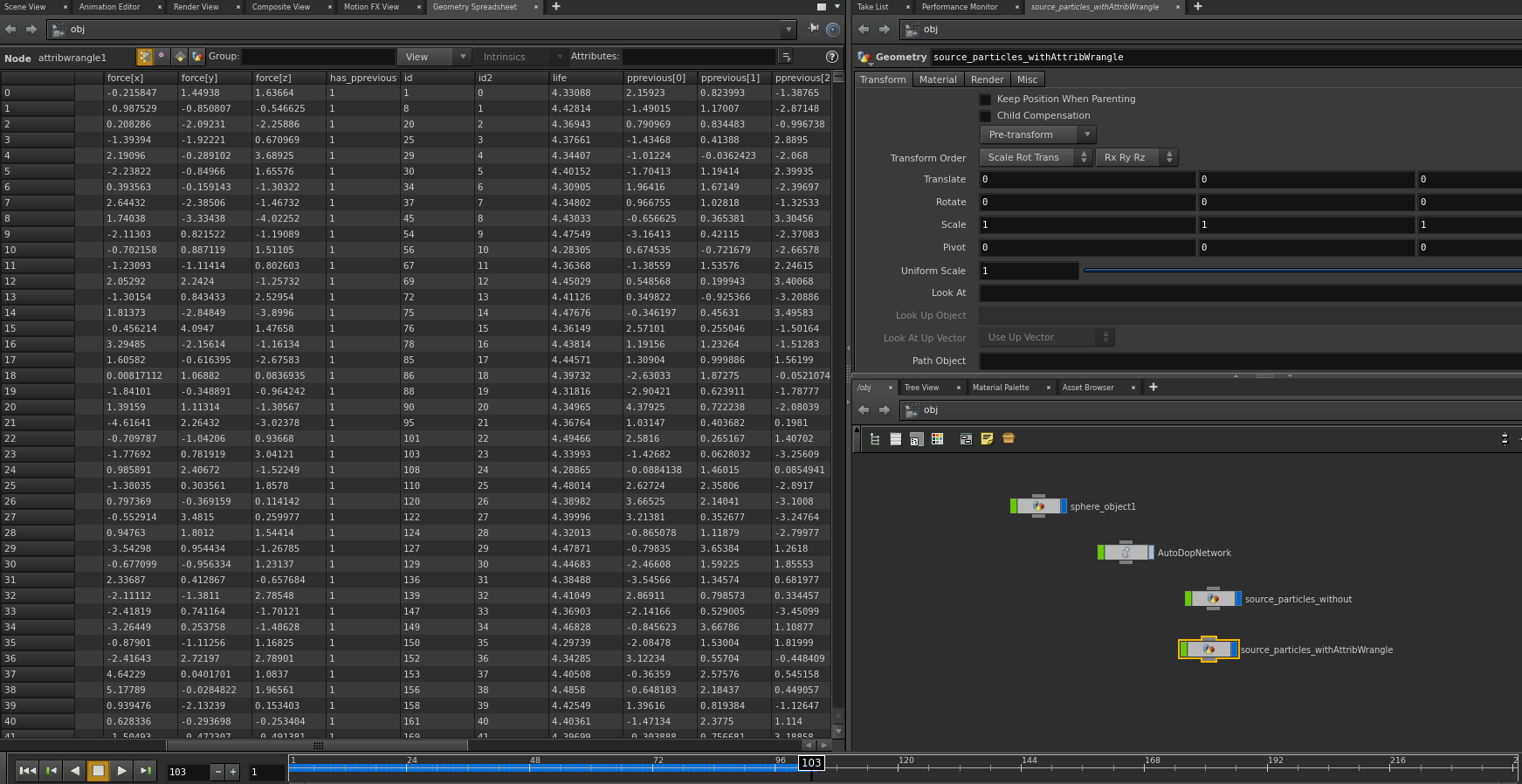

So I did some test to find how to imitate ID system from Pop Solver but on a Pyro Sim. And I found this : below the DOP Import and the scatter node in my pyro_import node, I lay down a AttribWrangle and I say : “i@id = @ptnum;”. And it works pretty good ! But there is a problem.
When I test this on my POP Solver to compare if my “fake” ID is fair compared to the true ID, we can see a slight different result after 50 frames of sim. GeometrySpreadsheet Example.png
Because particles dies, and the i@id = @ptnum generate id on the frame and not on the particle.
