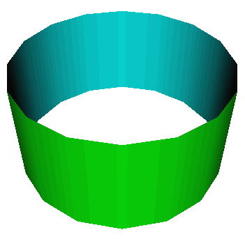

f1480187 Posted February 20, 2017 Share Posted February 20, 2017 (edited) Depends on what you meant by that. From the information provided, you probably don't need two-sided shader (1, 2) but assign material to different sides of box. If you add another set of material nodes and set their Group to another primitive number, it should work for you. Edited February 20, 2017 by f1480187 Quote Link to comment Share on other sites More sharing options...
