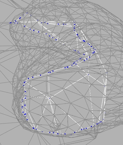

kni8_2k Posted November 17, 2005 Author Share Posted November 17, 2005 sorry for the late response, Thank you sibarick, what happened was I used an expression to see if my lists were empty.. but.. it doesn't quite fix it.. I noticed cases where the boolean mesh is intersecting the original asset in multiple places. and so Some parts of the boolean were successfull and others were not. but all the groups were filled. so still screwed.. now I have another problem and that is degenerate primitives.. I don't really understand why the polyreduce is creating them. I'm only using it to triangulate the mesh. Hmmmmmm.. maybe I'm going about this the wrong way... when going from a maya obj file to Houdini, is there a set of things I should go through to get the geometry CLEANED in houdini.. righht now I'm doing a poly reduce to triangulate, clean with all options on (which is causing some holes due to degerate Geo produced by the triangulate) and a fuse. Quote Link to comment Share on other sites More sharing options...
sibarrick Posted November 17, 2005 Share Posted November 17, 2005 sorry for the late response, Thank you sibarick, what happened was I used an expression to see if my lists were empty.. but.. it doesn't quite fix it.. I noticed cases where the boolean mesh is intersecting the original asset in multiple places. and so Some parts of the boolean were successfull and others were not. but all the groups were filled. so still screwed.. 22649[/snapback] How about adding a connection sop then a partition sop and checking how many groups it creates, of course you need to now how many intersections you were expecting...... hmmmmmm getting tricky, humans are good at this machines are not. How about RFEing a fuzzy logic AI sop? To triangulate a mesh use the divide sop. The cookie sop will pre-triangulate anyway so you shouldn't need it. Sounds like Maya producing messy geometry to me. Quote Link to comment Share on other sites More sharing options...
