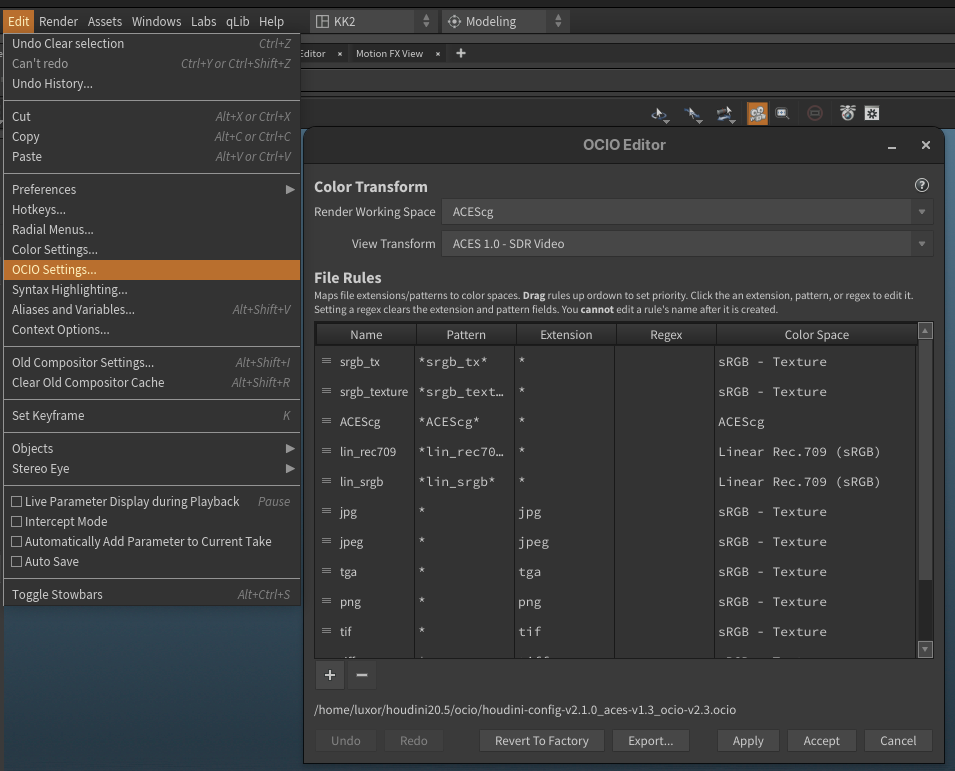

That's correct in Houdini 20.5 ACES is already built-in. You can find the settings under Edit → OCIO settings. There’s also an explanation there about how different files are interpreted. For example, if the filename contains ACEScg, it will be interpreted as ACES, but I’m not 100% sure about this — I thought it was reading that from the metadata. That’s probably why, since you exported an EXR, it’s being interpreted as Linear sRGB.
OCIO Settings
Whenever I want to make sure a plate is in ACES, I export it from Resolve and choose ACEScg as the Output Transform. That way I know it’s ACES in all applications. I also include it in the filename and make sure it’s saved in the metadata.
This works for me, but if someone has a better or more technically accurate explanation, I’d love to hear it.
