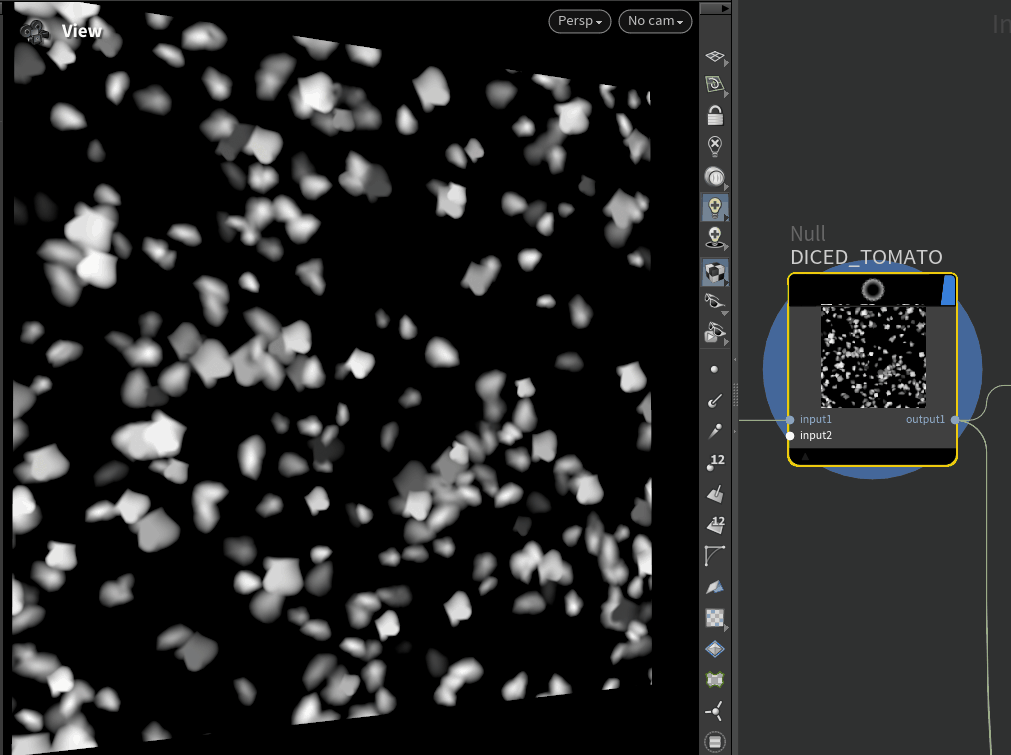

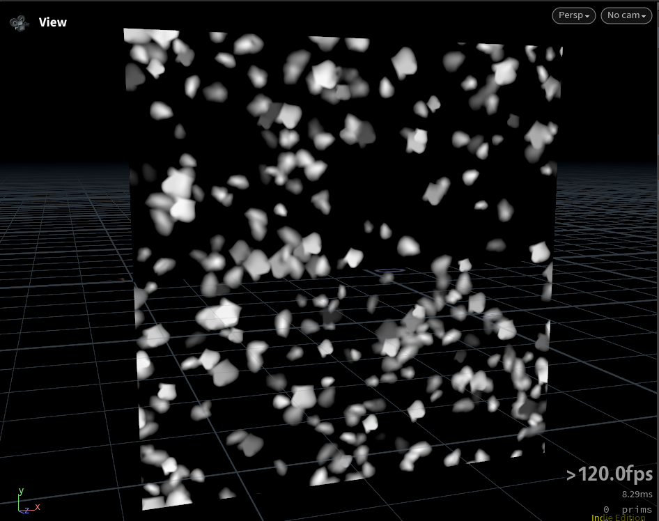

I have a mono image in Copernicus. I want to give color to the white areas, and leave black the black areas.
What's the easiest way to do that?

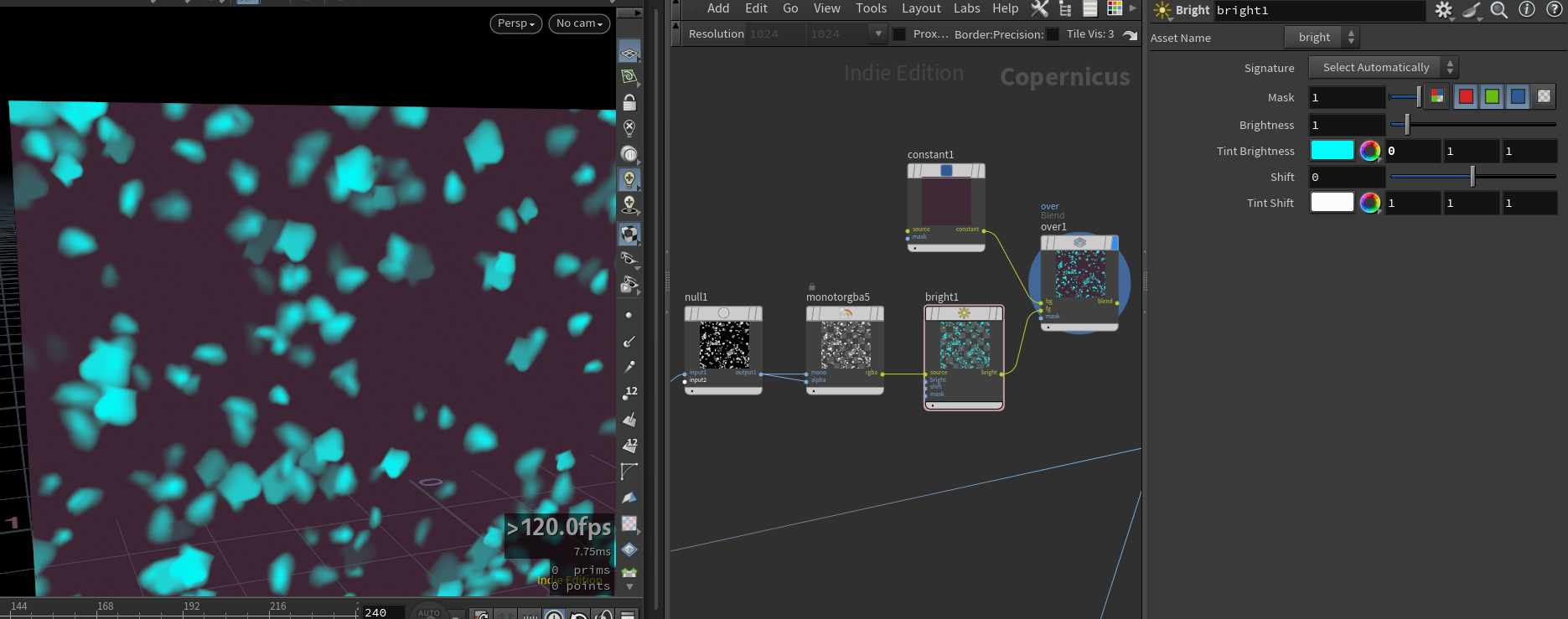

And what if i want to give Alpha 1 to the white areas and 0 to the black areas? Mono to RGBA works but produces these black outlines:
I found that the Bright COP has a tint parameter which seems to be perfect to colorize.
(and the black outlines I mentioned above are probably just viewport thing, here they are not there)

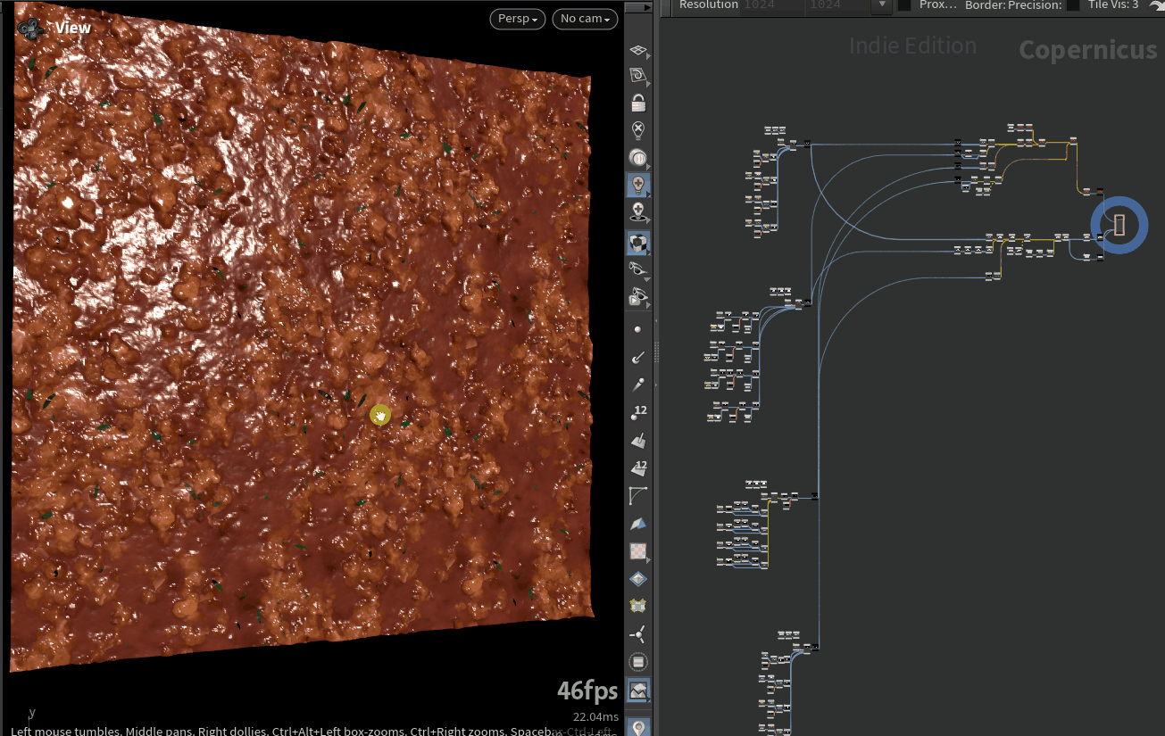

I'm working on a personal project starring a pasta monster, I had to create a bolognese sauce for it.
I tought it could be fun for others (at least to look around in COPs).
Have fun with it!
bolognese_cops.hiplc
I followed this article and tried to replicate what he did in Substance Designer, but using COPs. Copernicus is indeed amazing!!
https://80.lv/articles/making-fusilli-pasta-material-with-substance-3d-designer-houdini
The ingredients:
