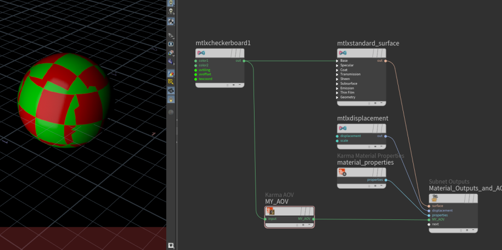

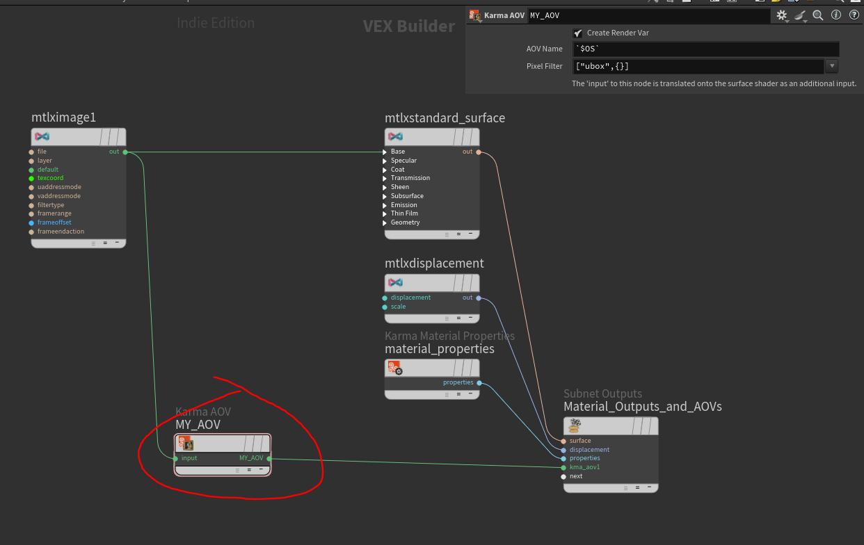

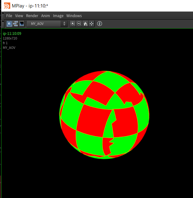

bentway23 Posted August 16, 2025 Author Share Posted August 16, 2025 Thanks! Got a quicker solution from another forum--just create a karma AOV node coming out of your matx image node. The raw diffuse AOV will appear with your other AOVs with whatever name you gave that node. Quote Link to comment Share on other sites More sharing options...
bentway23 Posted August 16, 2025 Author Share Posted August 16, 2025 Incidentally, in case any other previously-uninformed seekers stumble upon this, it doesn't have to just be an image node for this to work. Quote Link to comment Share on other sites More sharing options...
