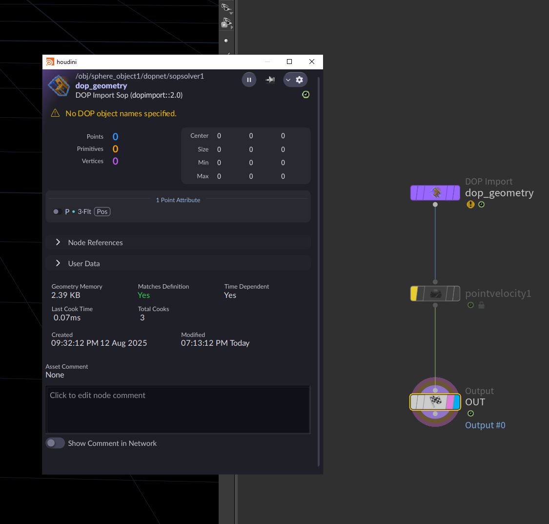

plazadelmar Posted August 18 Share Posted August 18 Inside DOP and SOP Solver I'm getting the error message "No DOP object names specified," and I have no idea how to fix it. COLORFUL FLUID SPLASH.hiplc Quote Link to comment Share on other sites More sharing options...

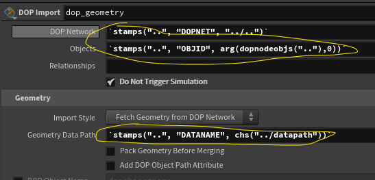

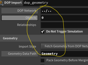

DLCool Posted yesterday at 05:59 PM Share Posted yesterday at 05:59 PM Hi there. I guess the point is the expressions works only when the solver is activated. In your case this is frame 5: Have a look. At frame 5 there is not an error: You could enter node parameters manually, without expressions to rid of errors: but I don't know if it worth it. Regards. 1 Quote Link to comment Share on other sites More sharing options...
