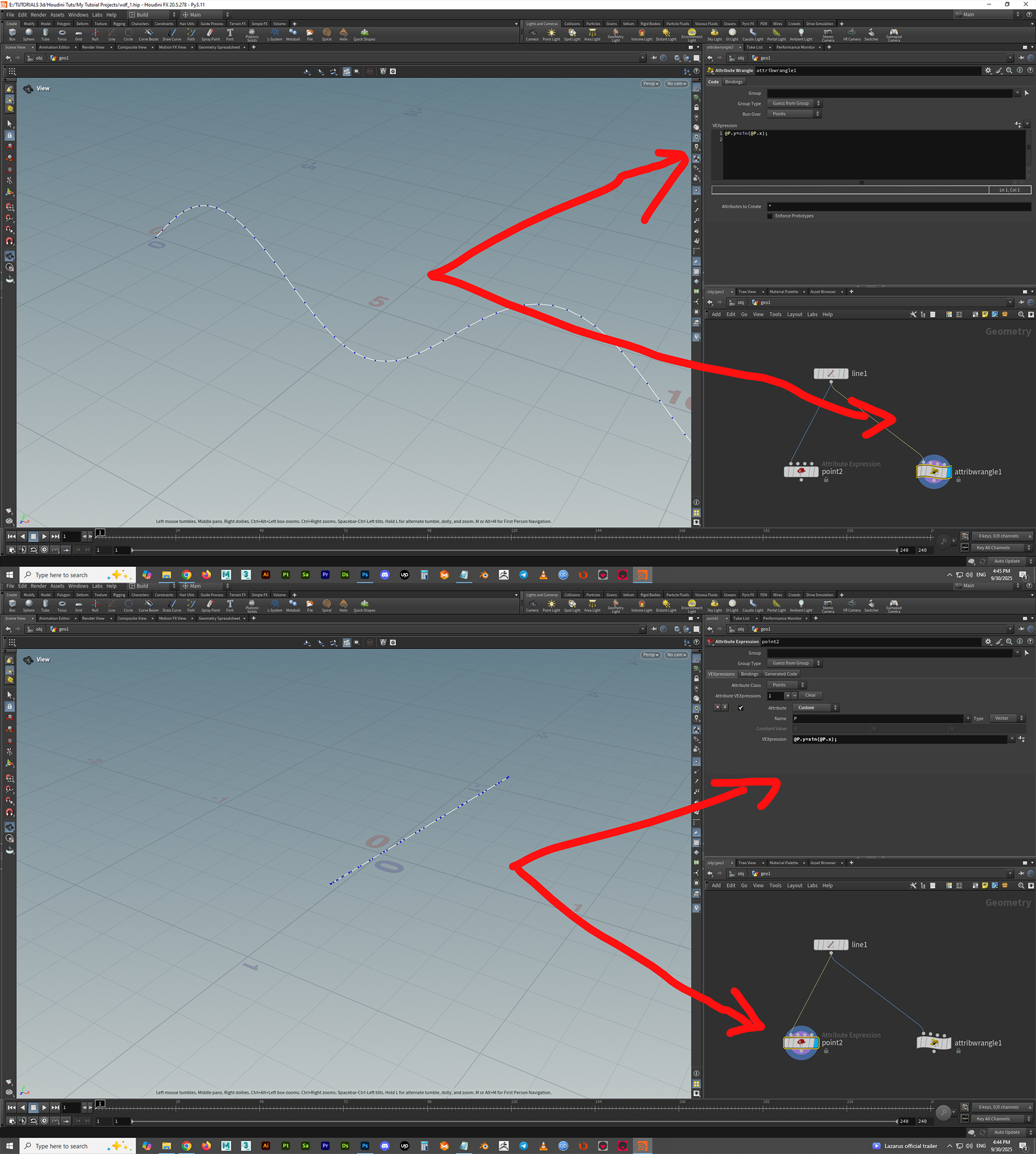

4) See attachment . Why when I type @P.y=sin(@P.x); in an attribute wrangler attached to a horizontal line it gives me spiral (like it should)  but when I do same in point node's VEXpression field it gives me some weird line in viewport (and its P.x coordinates are changed for some reason as I see in the spreadsheet) and I need to type @P.x=self;@P.y=sin(@P.x);@P.z=cos(@P.x); in order for spiral to appear forcing P.x to stay same (not to be changed change by Point node like before). Meaning that point node affects P.x component even when I`m not touching it while wrangler only changes what you tell him to. It was tested on different versions of Houdini.

  4. Seems you did not read the docs for the attributeExpression sop node. The expression should look like this: set(self.x,sin(self.x),cos(self.x)), but I recommend to use a wrangle node, I didn't know the attributeExpression node exists until now.
