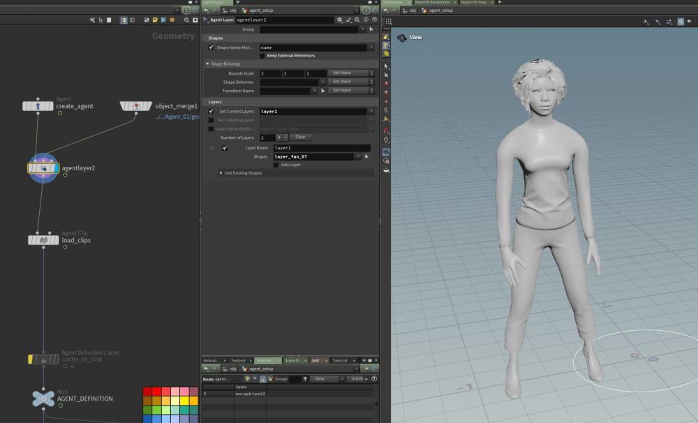

1. The first image has the output of my Agent sop. I'm reading in from a modified Character rig that works properly. The clips make him move fine.

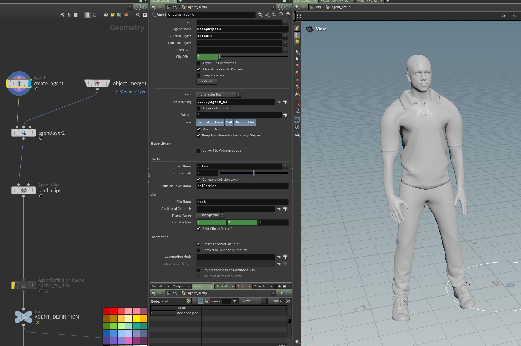

2. Second image has my alternate model of the girl in T-Pose. All the bone deform attributes are there, so it should work fine.

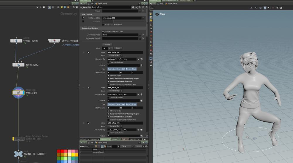

3. In image three you can see the output from my agent layer sop. The model seems to be deforming properly, so the new mesh is now added to the shape library.

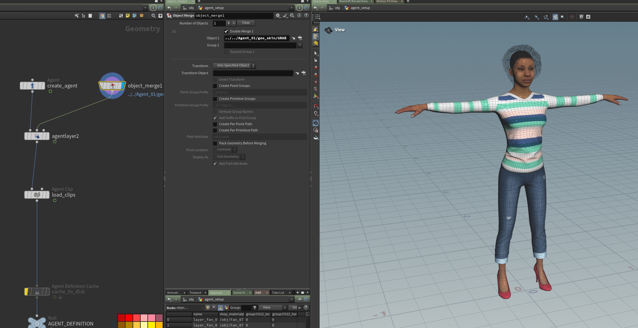

4. Shows the load clips section. She's posed correctly at the frame I'm at, but she won't move with the clips when i scrub the timeline. She's frozen.
