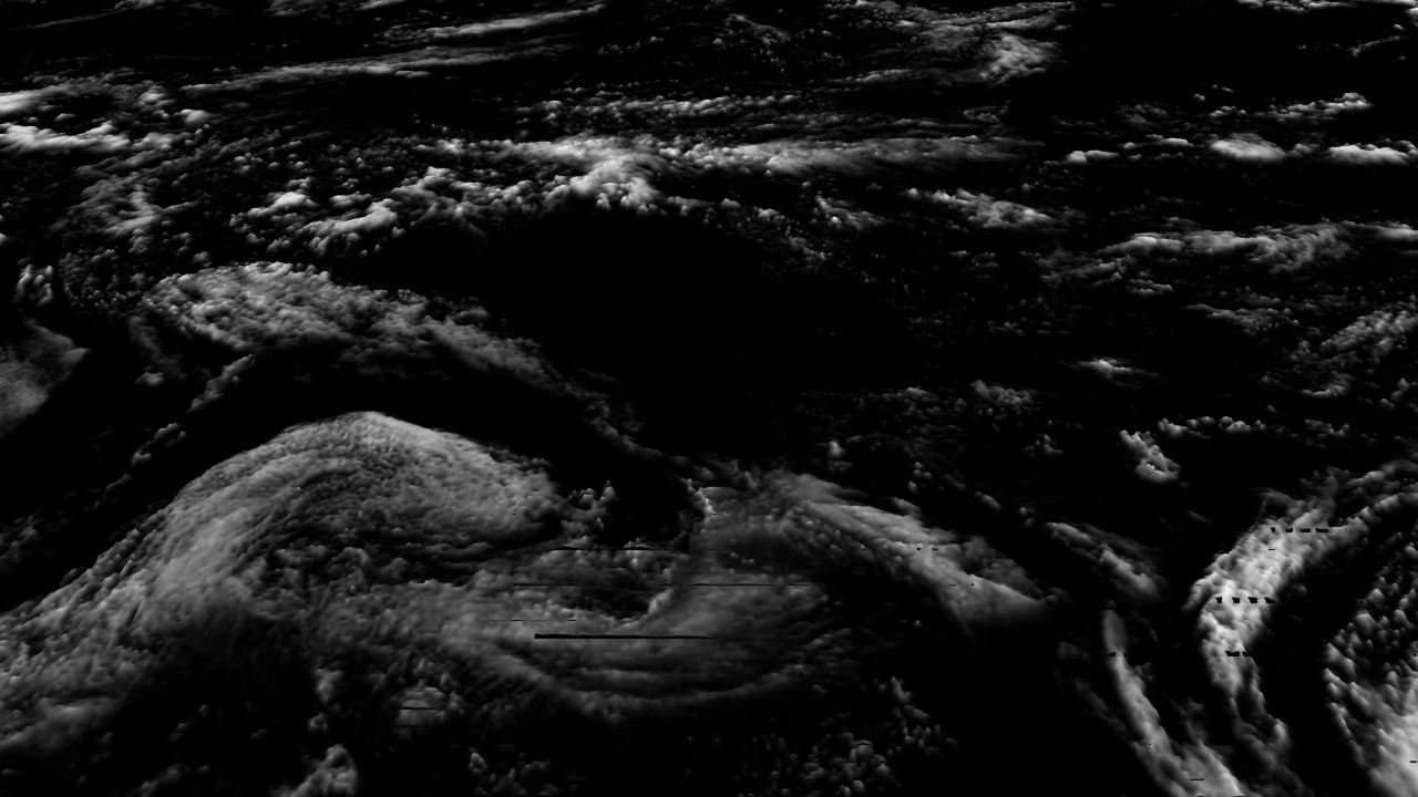

blackchicken Posted June 18, 2009 Share Posted June 18, 2009 Hello guys I have some little problems. I create some meteoritic explosion on earth (stereo), and have little problems. First with displacement,. Hi res map of clouds, constant material I add mantra vex displace map, same map as colour and opacity. All is great only some little problems near camera, If smaller resolution, holes is on another place, Where is the problem? object is simple plane 40*40 sub and render tab mantra subdiv on another little problem is with deep shadow, spot light, pix sam 4 4 softnes 3 quality 1, 1024 res, As you can see there is some lines, I tried change shadow bias but not help, I cant find any solution. Do you know where it could be? some little antoher questions, still must learn alot but I love houdini, mantra is great render, perfectly implemented. Some little questions. 1, Is there some solution how I could quick render only selected objects? 2, has houdini some layers? no takes, like render layers, but like standart layers like in maya? 3, how I could put vex inside material? I have some shader for smoke, mix from miguel and some odforce shaders, but I olways must copy vex from older projects scene then create material in new. Some houdini materials has wex directly inside. 4, It is possible render glow in mantra or all is post 5, How I could invert group, select something and invert selection will be my group 6, Sim data, If I simulate DOP data, save it to the disk, then from dop network import it back, dop import dont import it. I dont need bgeo seq. For what is sim data? 7, Keyed camera. Why, If I have keyes on cam, so I have it definitely set for shot, If I move or rotate, keyes will add new numbers, why> it is possible turn it off somewhere? I like maya stile, you could rotate cam how you want, but if you move next frame cam jump back to keyed position... 8, Has houdini something like SETDRIVEN KEY like in maya? I saw python dvd from 3dbuzz there they programing something like that but I dont buy it yet. Has houdini something in package? Thanks a lot, There is test, a lot of work still, but in stereo looks realy cool Sorry for stupid questions but you know, new software a lot of questions :afro: Quote Link to comment Share on other sites More sharing options...
Michael1 Posted June 19, 2009 Share Posted June 19, 2009 I think the answer to your first question might be that you need to set your displacement bounds on your geometry. If you set it above 0 this should stop the holes appearing in the geometry. Cheers. Quote Link to comment Share on other sites More sharing options...

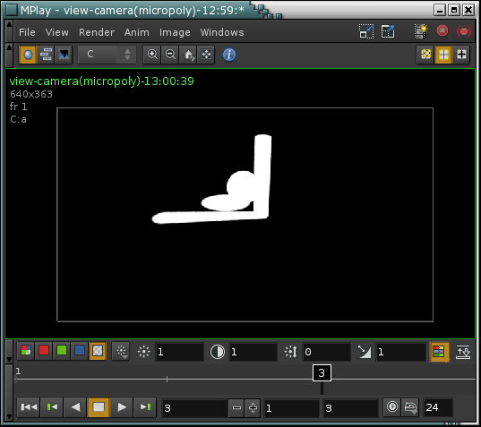

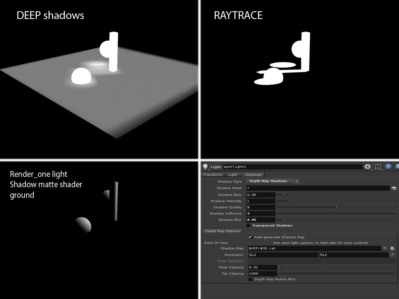

blackchicken Posted June 23, 2009 Author Share Posted June 23, 2009 Thanks a lot michael, I choose another material (maple leaf) which haz opacity and displacement with bound and all is ok. But I have still problem with deepshadows. Lok at the picture, I thing that I must smooth shadows to destroy all artefact but problem is with shadows matte shader. Alpha is no solid where is no shadows, If I choose raytrace shadow, All is ok for compositing. Where is problem? Thanks a lot .....BC.... Quote Link to comment Share on other sites More sharing options...
sam.h Posted June 24, 2009 Share Posted June 24, 2009 Thanks a lot michael, I choose another material (maple leaf) which haz opacity and displacement with bound and all is ok. But I have still problem with deepshadows. Lok at the picture, I thing that I must smooth shadows to destroy all artefact but problem is with shadows matte shader. Alpha is no solid where is no shadows, If I choose raytrace shadow, All is ok for compositing. Where is problem? Thanks a lot .....BC.... make a new spotlight and make sure that when you look through the light that you aren't seeing too much space around your objects. turn up the resolution of the shadow map and leave everything else at default and see if it is better .... I also took out the box from the shadow mask on the spotlight. Quote Link to comment Share on other sites More sharing options...
blackchicken Posted June 25, 2009 Author Share Posted June 25, 2009 thanks a lot SAM.H yes, It was problem with shadow mask of ground, but what if I need cast shadows from the ground? What is the solution? Thanks a lot again Quote Link to comment Share on other sites More sharing options...
