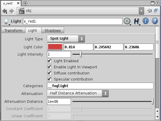

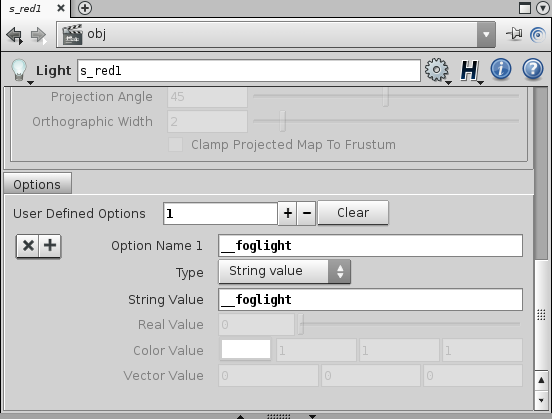

CraigS Posted July 9, 2009 Author Share Posted July 9, 2009 Ok, I must still be missing something. I've tried the categories section and adding in user defined options from the R14 set and neither works. I've attached screenshots in case it looks like I'm missing something or entering something incorrectly... Quote Link to comment Share on other sites More sharing options...
