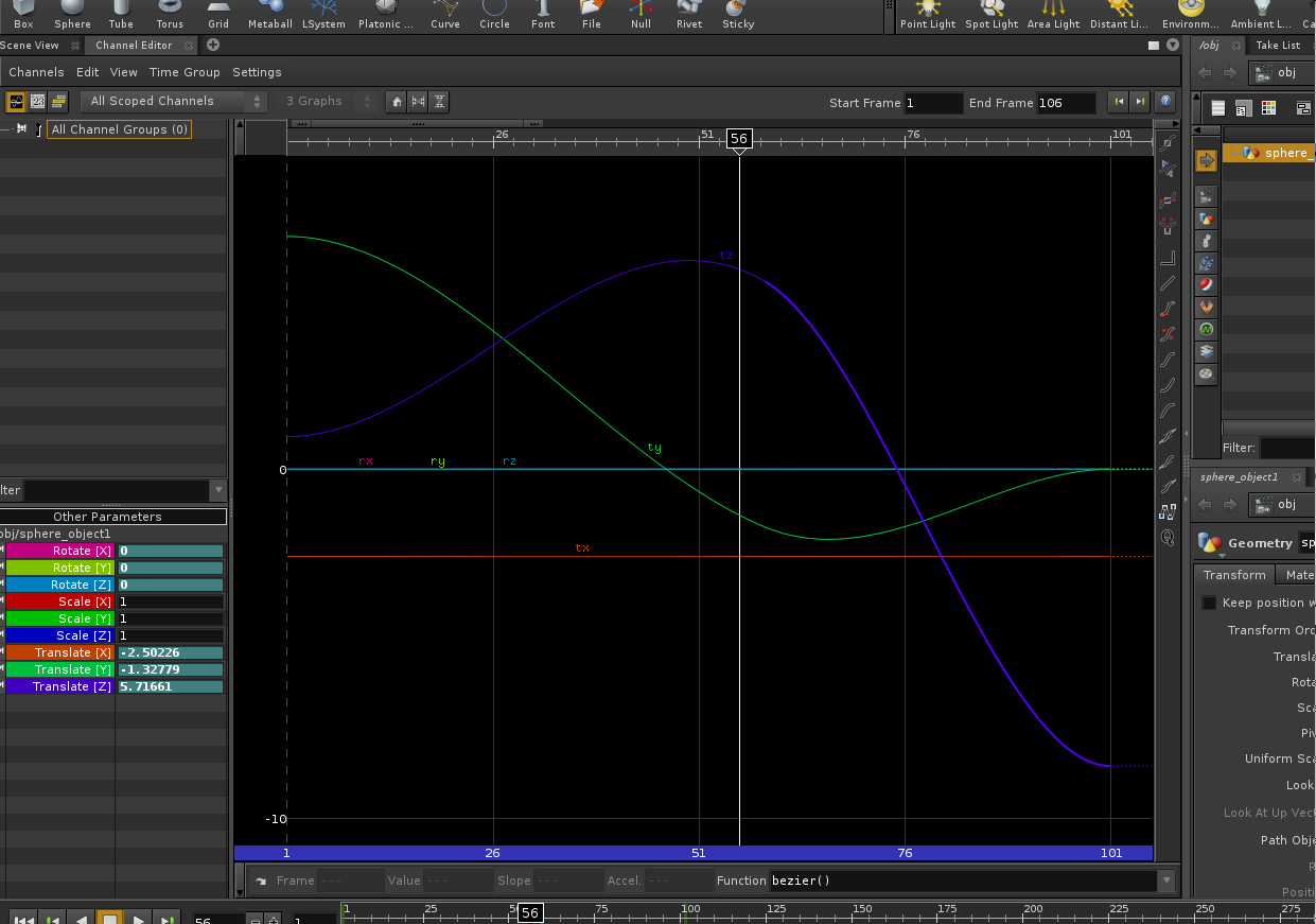

Farsheed Ashouri Posted September 7, 2009 Share Posted September 7, 2009 I send the screen shot. I can't select any keys. There are keys with my object and I select the object correct. Quote Link to comment Share on other sites More sharing options...

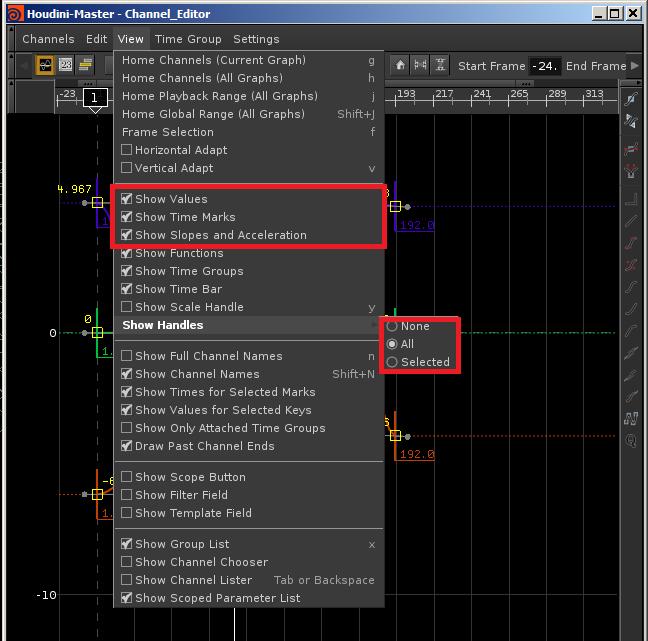

symek Posted September 7, 2009 Share Posted September 7, 2009 I send the screen shot. I can't select any keys. There are keys with my object and I select the object correct. My guess is you should take a closer look of those settings (red squared). Quote Link to comment Share on other sites More sharing options...
Farsheed Ashouri Posted September 8, 2009 Author Share Posted September 8, 2009 You are right. Thanks. You solved my problems. Quote Link to comment Share on other sites More sharing options...
