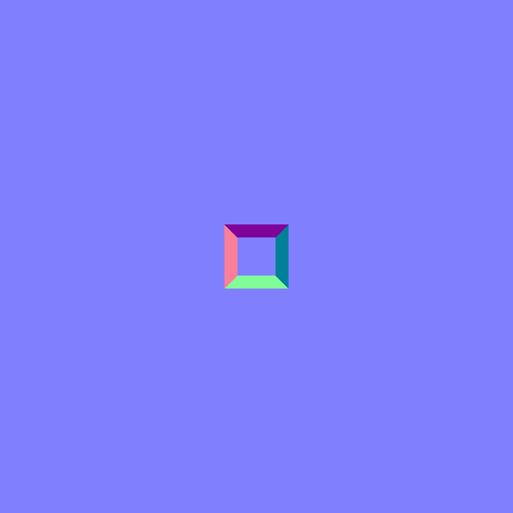

After the sculpt session, I import in Houdini the low poly version of the new jersey and the normal map obtained by ZBrush, but some days ago I noticed some artifacts, so today I made a simply scene: a grid with a material, a light and a camera.
This is the normal map I projected on the grid: post-2959-128040835958_thumb.png

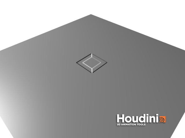

The final render is: post-2959-128041010814_thumb.png but if you compare it with Blender render: post-2959-128040847186_thumb.png
you can see the Houdini render is not as expected.

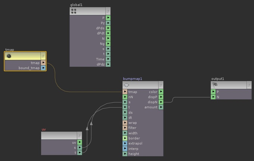

I've created a very simple shader:
As suggested here: http://learning3dfromscratch.blogspot.com/2009/06/zbrush-to-houdini-texture-and-normal.html
So, the question is: what am I doing wrong? is it my fault? or does Houdini uses normal maps in different way?

The bumpmap VOP takes the derivative of the texture map, so it's not what you want. Just use a regular texture VOP and pipe that into your normal. If the texture map's range is 0-1 (which is what it looks like) then you'll need to map that to -1 to 1 first, and then possibly normalize.
