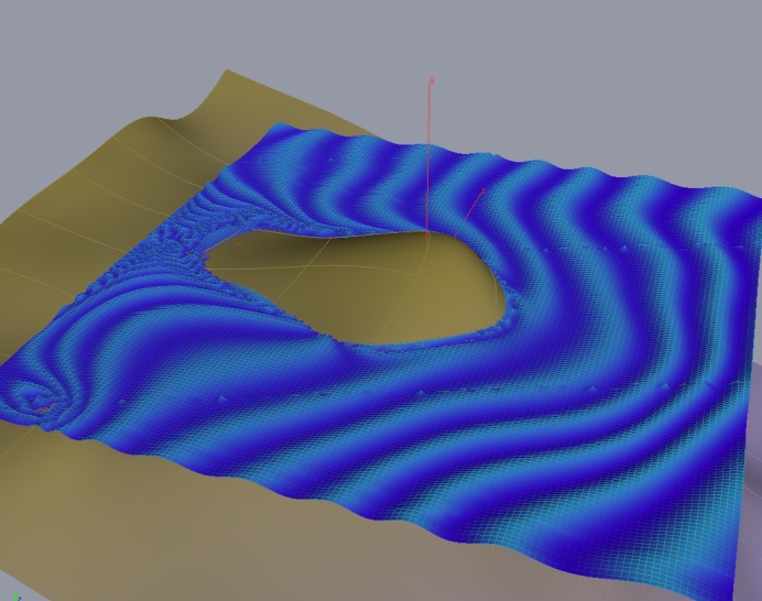

Macha Posted November 25, 2010 Share Posted November 25, 2010 It's an old post but I thought this might be interesting. A long time ago when I first touched Houdini I tried a similar thing. Unfortunately it is incomplete and I forgot mostly what I was doing but I think the same thing could be implemented into HOT (I am trying now but I can't get the HOT vex nodes to work...). The idea is to measure the distance to the ground and use that to modify amplitude, phase and speed. Perhaps somebody can help translating that into HOT? mywave.hipnc Quote Link to comment Share on other sites More sharing options...

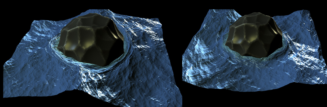

Macha Posted November 25, 2010 Share Posted November 25, 2010 I managed to get the HOT VEX working by using a different compile of HOT (wish I could do that myself!). It seems the vex node can for the most part not be changed on a per-point case. Only s and t seems to respond. The link and images below show the result. If I could change phase, amplitude and frequency in the same way I am sure the waves would diffract around the rock. Vimeo: Quote Link to comment Share on other sites More sharing options...

Macha Posted November 30, 2010 Share Posted November 30, 2010 why couldnt you just define several HOT wave-types and blend them with a point attribute? The thinking is this: As the distance to an object (ground) decreases the wave slows, increases in amplitude, and shifts phase. This changes from point to point, so if I wanted to include that into the ocean wave it would have to be calculated for every point. Blending gives a nice result but does not create the ripples and patterns that an object in the path of a wave creates. I tried a flip fluid version. It's hard to control and only suitable for small details, I think. Quote Link to comment Share on other sites More sharing options...
