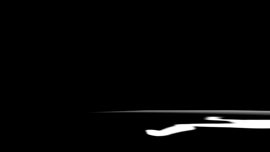

borisb2 Posted November 11, 2010 Author Share Posted November 11, 2010 here's the alpha of a test rendering of the shadow pass. As you can see the border of the groundplane gets this grdient, no matter how big that plane is. At a bias of 3-4 it fades away (but with also half of the wanted shadow biased away) There must be a setting somewhere.. Again, I'm having particles to render - is there another method than deep shadow maps to efficient render selfshadowed particles? Quote Link to comment Share on other sites More sharing options...
Macha Posted November 11, 2010 Share Posted November 11, 2010 If you open the deep shadow map (in mplayer if its .rat), does that border coincide with the border of the shadow map by any chance? Quote Link to comment Share on other sites More sharing options...
borisb2 Posted November 11, 2010 Author Share Posted November 11, 2010 no, its far outside the shadow map .. I can see that also by looking through that light.. must be something with the bias? Quote Link to comment Share on other sites More sharing options...
SpencerL Posted November 11, 2010 Share Posted November 11, 2010 (edited) no, its far outside the shadow map .. I can see that also by looking through that light.. must be something with the bias? it almost looks like the cone of your light. Maybe try having your cone bigger so that it includes the entire plane in camera? Edited November 11, 2010 by SpencerL Quote Link to comment Share on other sites More sharing options...
