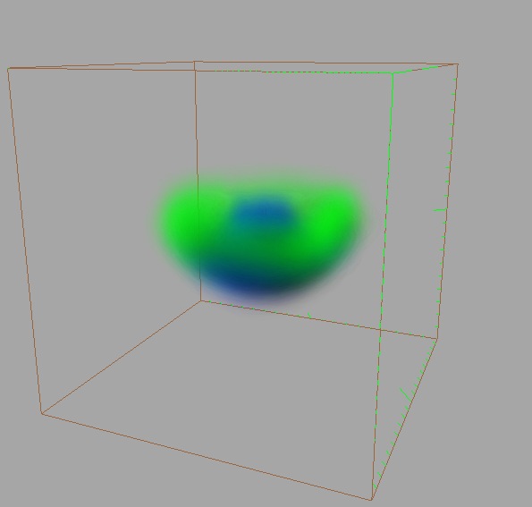

ryoji Posted December 13, 2010 Share Posted December 13, 2010 Hi I'm trying to make two types of smoke interact each other or one way. Like one smoke pushes others. It might be easy but I couldn't come up with good ideas with my poor knowledge of Houdini. I attached simple file. Any ideas are really welcome. Thanks for the help. Quote Link to comment Share on other sites More sharing options...

Macha Posted December 13, 2010 Share Posted December 13, 2010 I'm not a big DOPs expert but here is what I did: copy the pyroA vel field to pyroB... twoSmokesme.hipnc Quote Link to comment Share on other sites More sharing options...
ryoji Posted December 14, 2010 Author Share Posted December 14, 2010 Thanks a lot. This is what I wanted Quote Link to comment Share on other sites More sharing options...
Macha Posted December 14, 2010 Share Posted December 14, 2010 (edited) I made you an improved version with a gascalculate, so that you can blend the fields. I think a better way than the copysolver would be to access the pyroA's vel field directly but since both pyroA and pyroB vel have the same name, I'm not sure how to do that. pyroA:vel or pyroA/vel doesn't seem to work. twoSmokesmeb.hipnc Edited December 14, 2010 by Macha Quote Link to comment Share on other sites More sharing options...
