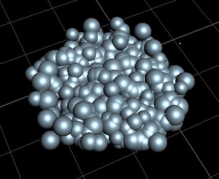

Macha Posted March 26, 2011 Author Share Posted March 26, 2011 Something along those lines maybe. Any ideas about shading? Transparent intersecting spheres are very expensive. foasm.hipnc Quote Link to comment Share on other sites More sharing options...
~nature~ Posted March 26, 2011 Share Posted March 26, 2011 Hi, Macha, I have some idea about it. according to my reading, foam shading should be the typical of level of details. for the mid and distant shot,usually foam is simulated using particles(birth,kill and convert into water) and finally rendered as mesh. for the distant part, texture should be sufficient, I remember Houdini 10 has the foam shader shipped with it. As for the mid one where detail begins to stand out, displaced subsurface scattering shading should do the job.Cellular noise is our best friend regarding the displacement shading. Sphere sim at this point is ok and maybe use metaball to produce the mesh so that the rough surface at the top of the foams continuity could be simulated to some extent. Quote Link to comment Share on other sites More sharing options...
ohiro2 Posted April 10, 2011 Share Posted April 10, 2011 Hi Macha, Here is the spot I worked on the foam while ago. It was not animated at all but shading wise, It is just a volume cloud inside transparent object with noise displacement. The volume cloud can give you a fluffy look. Hope this helps Quote Link to comment Share on other sites More sharing options...
