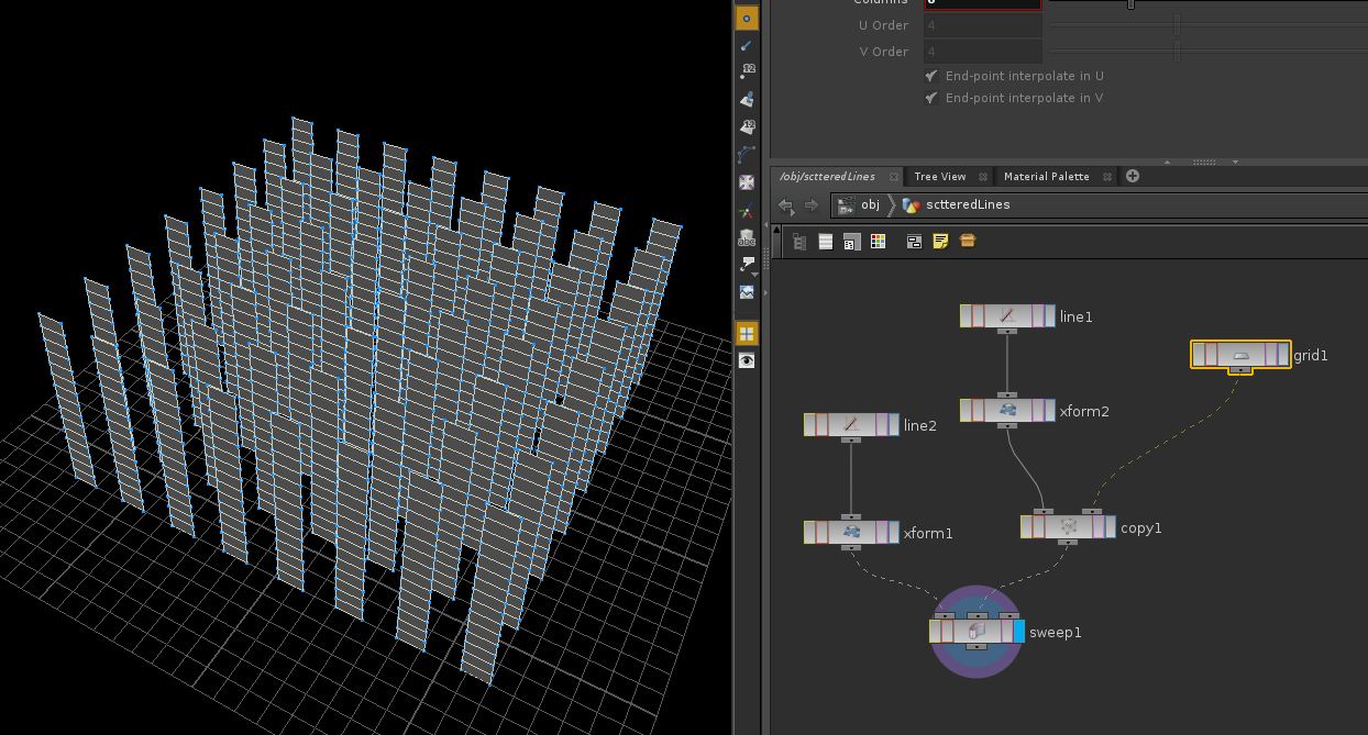

Bin Posted July 7, 2011 Share Posted July 7, 2011 Hi people, Got a question here: is it possible to randomize the rotation for each individual sweep parts? say, I got a line node copied onto a grid to get a bunch of target lines, and used another line sop to sweep onto the target to "extrude" along to get poly "stripes"(as the image), but how can I randomize the rotation individually along the normal direction of the copied lines?(to make the "stripes" spin in different angles) the "roll" channel in the sweep node spins them at a same degree, how can I differ individual "stripes"? the goal is to get the mesh generated along the target lines and random them a bit, so maybe there's other ways I can take? thanks rotateRandom.hip Quote Link to comment Share on other sites More sharing options...

anim Posted July 8, 2011 Share Posted July 8, 2011 to your original question/file just put this into Roll Parameter of Sweep SOP: 360*rand($PATH) Quote Link to comment Share on other sites More sharing options...
Bin Posted July 8, 2011 Author Share Posted July 8, 2011 to your original question/file just put this into Roll Parameter of Sweep SOP: 360*rand($PATH) Wow, thanks Tomas, it works well! but 1 step further, what if I want to control the amount of the roll value by painting wight on the grid? so the points with 0-1 weights accordingly rotate 0-360 degrees. is that possible if the sweep node is under the copy sop? Quote Link to comment Share on other sites More sharing options...
anim Posted July 8, 2011 Share Posted July 8, 2011 sure, here rotateRandom_weight.hip Quote Link to comment Share on other sites More sharing options...
Bin Posted July 8, 2011 Author Share Posted July 8, 2011 sure, here Awesome! that's exactly what I want! thanks~ really appreciate the help Quote Link to comment Share on other sites More sharing options...
