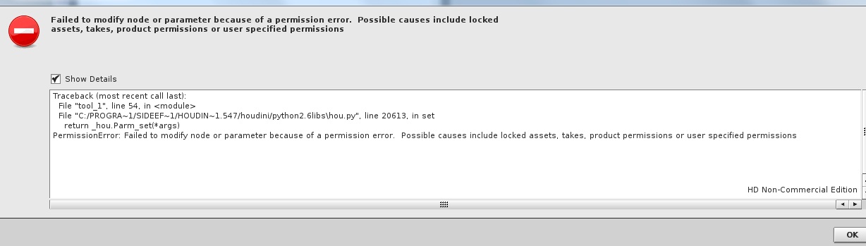

Hello world Posted September 19, 2011 Share Posted September 19, 2011 Hi I am getting this weird error. I have attached the snapshot of it. It tells failed to modify node or parameter because of permission error any solutions? Quote Link to comment Share on other sites More sharing options...
michael Posted September 20, 2011 Share Posted September 20, 2011 looks like a locked HDA to me... Quote Link to comment Share on other sites More sharing options...
Hello world Posted September 20, 2011 Author Share Posted September 20, 2011 looks like a locked HDA to me... could you tell me how to unlock it Quote Link to comment Share on other sites More sharing options...
Nerox Posted September 20, 2011 Share Posted September 20, 2011 could you tell me how to unlock it Fortunately that's relatively simple, you can RMB on the asset node and select 'allow editing of contents'. You can verify this by looking at the asset name in the network editor, it will turn to a dark red color. This probably solves your problem, it also allows one to dive in and edit the underlying networks. If you find your self willing to 'save' your edit, you can RMB and 'Save Operator Type'. Next time you place a node of this type it will inherit your changes. Cheers! Quote Link to comment Share on other sites More sharing options...
