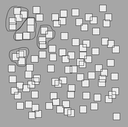

renderfan Posted October 27, 2011 Share Posted October 27, 2011 Hi! How can i group intersecting polygons like in picture? Is it possible with Partition-Sop? Thank you !! Quote Link to comment Share on other sites More sharing options...

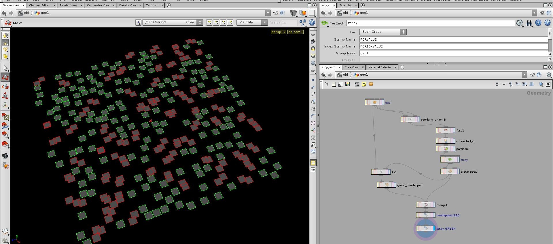

gaurav Posted October 28, 2011 Share Posted October 28, 2011 Hi! How can i group intersecting polygons like in picture? Is it possible with Partition-Sop? Thank you !! Yes. Possible with the mighty connectivity and partition combo. Will post hip file soon. Cheers!! Quote Link to comment Share on other sites More sharing options...
petz Posted October 28, 2011 Share Posted October 28, 2011 attached is one possible way hth. petz overlapping_prims.hipnc 1 Quote Link to comment Share on other sites More sharing options...
gaurav Posted October 28, 2011 Share Posted October 28, 2011 Yes. Possible with the mighty connectivity and partition combo. Will post hip file soon. Attaching hip. Cheers!! grpOverlap.hipnc Quote Link to comment Share on other sites More sharing options...
renderfan Posted October 30, 2011 Author Share Posted October 30, 2011 Thank you very much! That help me a lot. Next i need is to create not one group for all overlaps but groups for seperate intersecting polygons. Quote Link to comment Share on other sites More sharing options...
petz Posted October 30, 2011 Share Posted October 30, 2011 Next i need is to create not one group for all overlaps but groups for seperate intersecting polygons. hmmm, i thought thats exactly what the example i have posted is doing or do i completely misunderstand your question? petz Quote Link to comment Share on other sites More sharing options...
renderfan Posted October 31, 2011 Author Share Posted October 31, 2011 hmmm, i thought thats exactly what the example i have posted is doing or do i completely misunderstand your question? petz Petz you are right! I do not saw it. Thank you very much. Quote Link to comment Share on other sites More sharing options...
