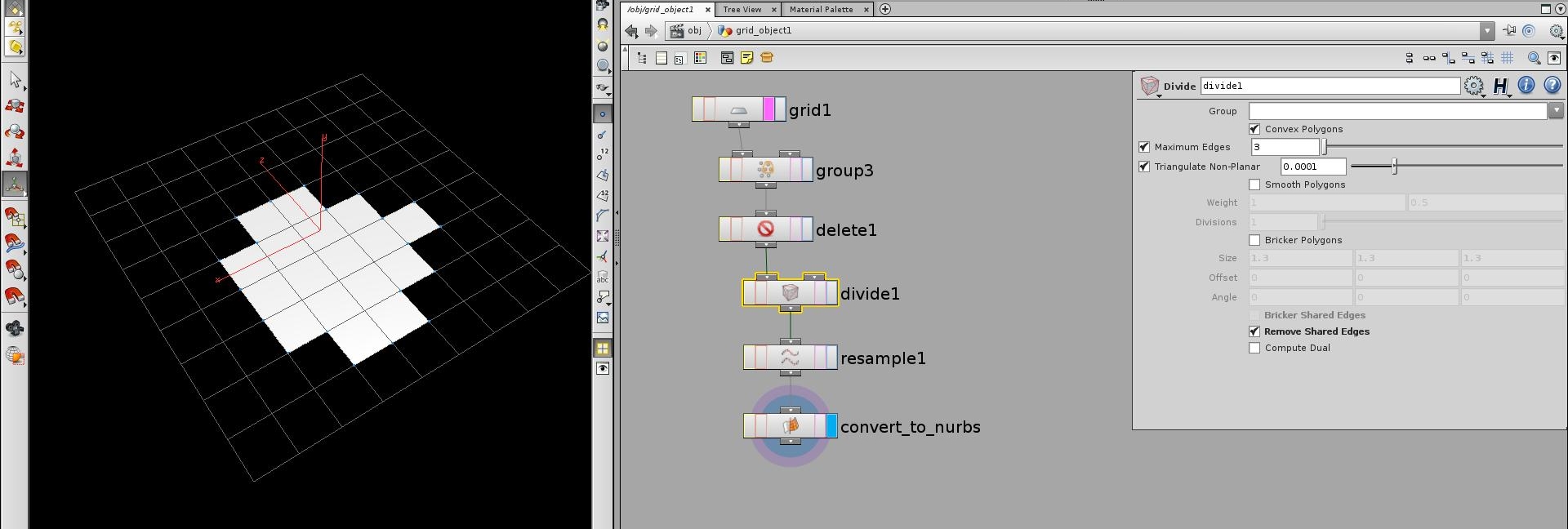

magneto Posted March 20, 2012 Share Posted March 20, 2012 I am trying to create a NURBS from the outline of my primitive selection group, but couldn't find a way. Is it possible? Thanks Quote Link to comment Share on other sites More sharing options...
rdg Posted March 20, 2012 Share Posted March 20, 2012 Try: Delete all but the group. DivideSOP with remove shared edges. ConvertSOP to NURBs. The DivideSOP will remove all but the outline. Quote Link to comment Share on other sites More sharing options...
magneto Posted March 20, 2012 Author Share Posted March 20, 2012 Thanks, that did the trick Quote Link to comment Share on other sites More sharing options...
gaurav Posted March 20, 2012 Share Posted March 20, 2012 (edited) here is one way. use divide sop to remove shared edges > convert sop to change it to nurbs. Edit : Ah.. Little Late. Edited March 20, 2012 by vectorblur Quote Link to comment Share on other sites More sharing options...
magneto Posted March 20, 2012 Author Share Posted March 20, 2012 Thanks man, still good Quote Link to comment Share on other sites More sharing options...
