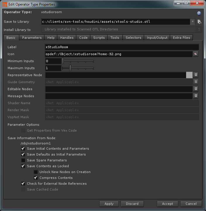

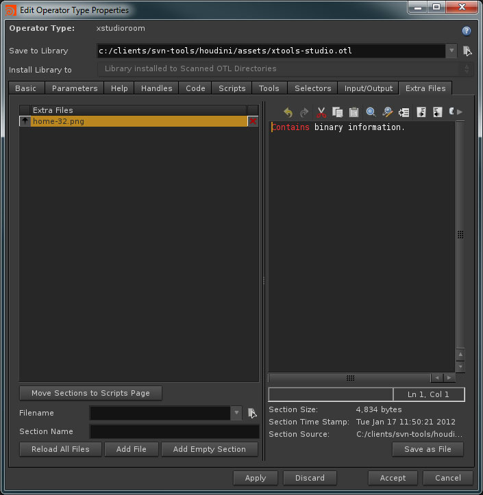

hopbin9 Posted March 23, 2012 Share Posted March 23, 2012 For an HDA, when I pick an icon from disk, it converts the path to something like: opdef:Sop/explode?IconImage You need a starting forward slash. opdef:/Sop/explode?iconimage.png The file name must match the name used in the extra files. Does it save it inside the OTL? Because I don't see it under the Extra Files tab. Is it a better practice to just add the file to Extra Files and refer to the icon there? You most likely forgot to click the add file button. You first select the file using the file browser, but then you have to add it to the extra files. Once it's in there, it will be saved in the OTL. I think the extra files keeps a file path for easy updating, but once it's in the OTL it will work on any computer. Also if 2 HDAs are using the same icon inside the same OTL, can you make a shared asset/icon for both? Yes. The path is the same for both. Lastly when writing your own help wiki,:#icon: opdef:Sop/explode?IconImage The path is wrong. opdef:/Sop/explode?IconImage or what ever it's called in the extra files. Note, the /obj/ network is opdef:/Object/etc.. 1 Quote Link to comment Share on other sites More sharing options...

hopbin9 Posted March 23, 2012 Share Posted March 23, 2012 (edited) No, I know I'm right See attached images. What I've found, is that Houdini has to be restarted sometimes to see an icon appear for an asset that has been just added to the extra files. Edited March 23, 2012 by hopbin9 1 Quote Link to comment Share on other sites More sharing options...
