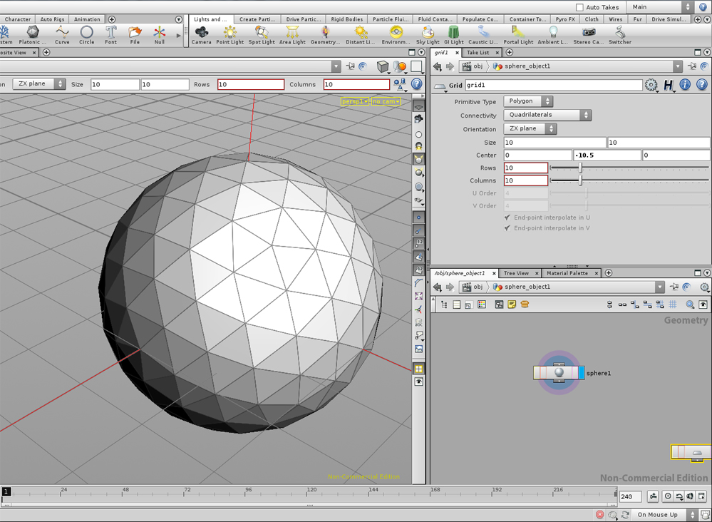

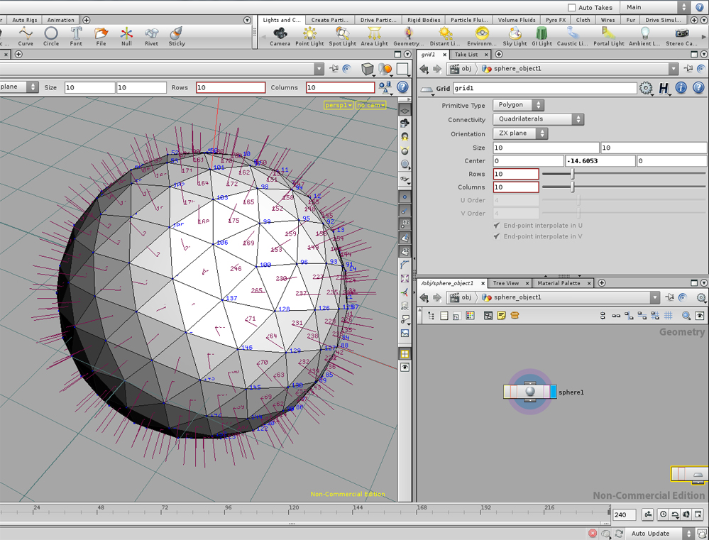

nomad Posted May 26, 2012 Share Posted May 26, 2012 Hello everyone! I have some troubles with houdini 12 It seems that display of ponits/normals doesn't work properly. Here i present the screenshot out from houdini 11 , where everything is ok. And the second the screenshot out from houdini 12 (the same configuration). I try to switch on the visualization of points (, number of points, normals, etc) , but nothing changes. Do I miss something? Quote Link to comment Share on other sites More sharing options...
Annon Posted May 26, 2012 Share Posted May 26, 2012 Yeah I've had some issues in H12 with the display. Go to Houdini Preferences>3D Viewports>Scene Renderer and change which one you use. GL3x seems to have the best features, but H11 seems to be more reliable although slower. Quote Link to comment Share on other sites More sharing options...

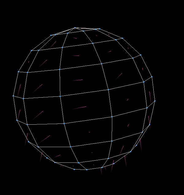

Guest mantragora Posted May 26, 2012 Share Posted May 26, 2012 I got similar problem but with primitive normals. Even with simple sphere they look like on attached picture. Quote Link to comment Share on other sites More sharing options...
crin Posted May 26, 2012 Share Posted May 26, 2012 Sometimes they'll show up if you have a different node selected than your display node. But switching to h11 viewport is probably the best answer. Quote Link to comment Share on other sites More sharing options...
3__ Posted May 27, 2012 Share Posted May 27, 2012 Send a bug report, let us know the response. Quote Link to comment Share on other sites More sharing options...
nomad Posted May 27, 2012 Author Share Posted May 27, 2012 ChristianW , thanks for the answer. In my case, I believe it it the best solution. Quote Link to comment Share on other sites More sharing options...
malexander Posted May 28, 2012 Share Posted May 28, 2012 Having Scene AA on with Nvidia drivers close to the minimum recommended version (256) seems to cause this problem. You can either upgrade the driver to a more recent version (290 or 295 series), or turn scene AA off. Quote Link to comment Share on other sites More sharing options...
