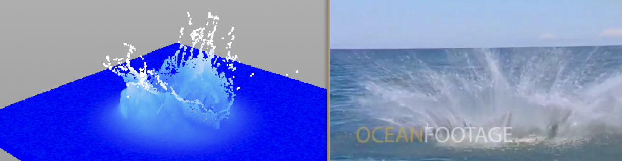

bluediamond Posted July 19, 2012 Share Posted July 19, 2012 I want to create a dolphin jumping into the water that makes this water splash(right image). I've been testing.. and I can't get the motion right. Can't get the thin layer of the water, and the height. Mine tends to be teared apart a lot... Any advice please? Thank you so much... question1.hip Quote Link to comment Share on other sites More sharing options...

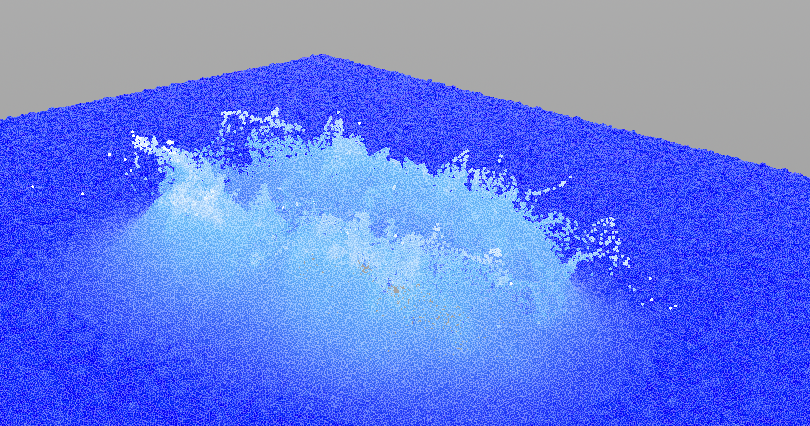

woodenduck Posted July 20, 2012 Share Posted July 20, 2012 I think you'll get much better results just by increasing the resolution. I reduced the particle separation to 0.05 and particle radius scale to 0.8 and got this Quote Link to comment Share on other sites More sharing options...
Fabiano Berlim Posted July 20, 2012 Share Posted July 20, 2012 Well, the flip fluid should be only the mesh. What do you really need is an extra pass of foam in top. Look for the waterfall tutorial in sesi site. 1 Quote Link to comment Share on other sites More sharing options...
bluediamond Posted July 23, 2012 Author Share Posted July 23, 2012 Thank you! I will try lowering the particle separation. Quote Link to comment Share on other sites More sharing options...
