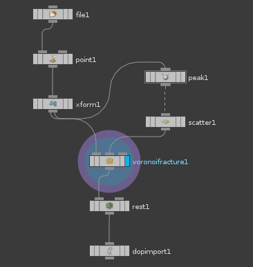

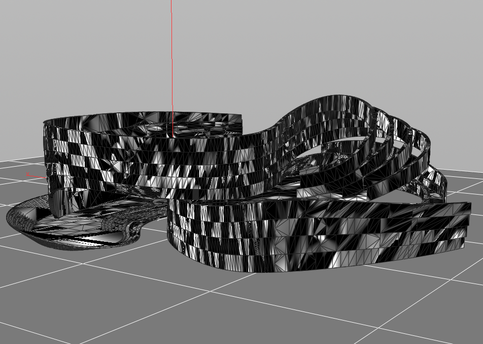

baruch Posted August 1, 2012 Share Posted August 1, 2012 Hello. I have a Problem when I'm adding voronoifracture to my network my model looks corrupted.. (2 images is attached) Maybe because the model is with Triangles ?? its an obj model. By the way what is the best way to make an explosion of this structure? Thank you. Quote Link to comment Share on other sites More sharing options...

ben Posted August 1, 2012 Share Posted August 1, 2012 You didn't include you .obj Just check the red flag (locked) on your file node. Quote Link to comment Share on other sites More sharing options...

woodenduck Posted August 2, 2012 Share Posted August 2, 2012 Not sure I know what's going on there! I would say though, that the geometry looks in a pretty bad way to start with. Did you build it in Houdini? Quote Link to comment Share on other sites More sharing options...
ben Posted August 2, 2012 Share Posted August 2, 2012 yep, your geometry is a mess. It's the only problem ... Quote Link to comment Share on other sites More sharing options...
baruch Posted August 2, 2012 Author Share Posted August 2, 2012 it's a google model from sketchup convert with maya to obj.. Quote Link to comment Share on other sites More sharing options...
woodenduck Posted August 3, 2012 Share Posted August 3, 2012 That explains the terrible polys! It should be pretty easy to construct in Houdini. I made a start, it's just a few curves and poly extrudes. See attached .hip Quote Link to comment Share on other sites More sharing options...

baruch Posted August 4, 2012 Author Share Posted August 4, 2012 Thank's Good idea.looks good.. It's better to solve the problem this way. Quote Link to comment Share on other sites More sharing options...
