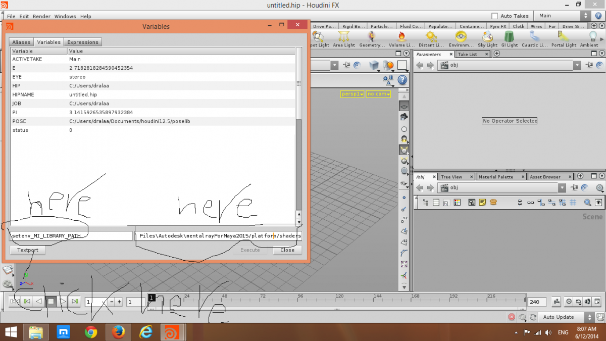

1 - in this page http://odforce.net/wiki/doku.php?id=mentalraysetup there is a way to setup mental ray to houdini but I didnot understand anything .Example , setenv MI_LIBRARY_PATH ”/path/to/mentalray_version/platform/shaders” I replaced the path with C:\Program Files\Autodesk\mentalrayForMaya2015 . Is that right ?? and in the path I replaced there are no folder called platform !!! ,so am I use a wrong version of mental ray ?
in the picture the way I do the things in the page
post-11697-0-33765800-1402553429_thumb.p
post-11697-0-56645000-1402553462_thumb.p

1-6. You need to use standalone mental ray, not maya's mental ray plugin. Same with Vray.
