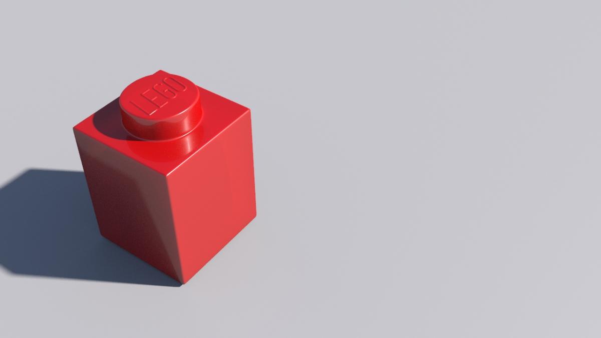

I would like to be able to map a displacement material on a geometry and then subdivide it only at rendertime with Mantra, but when I do this the material / displacement gets distorted. I understand that subdivision will do this, therefore I made a version with a subdivision sop before adding the UV and this works, but the reason I want to subdivide in mantra at rendertime is that i want to make a lot of copies of the geometry which will slow everything down considerably.
How does one utilize rendertime subdivision with precise mapping of displacement?
