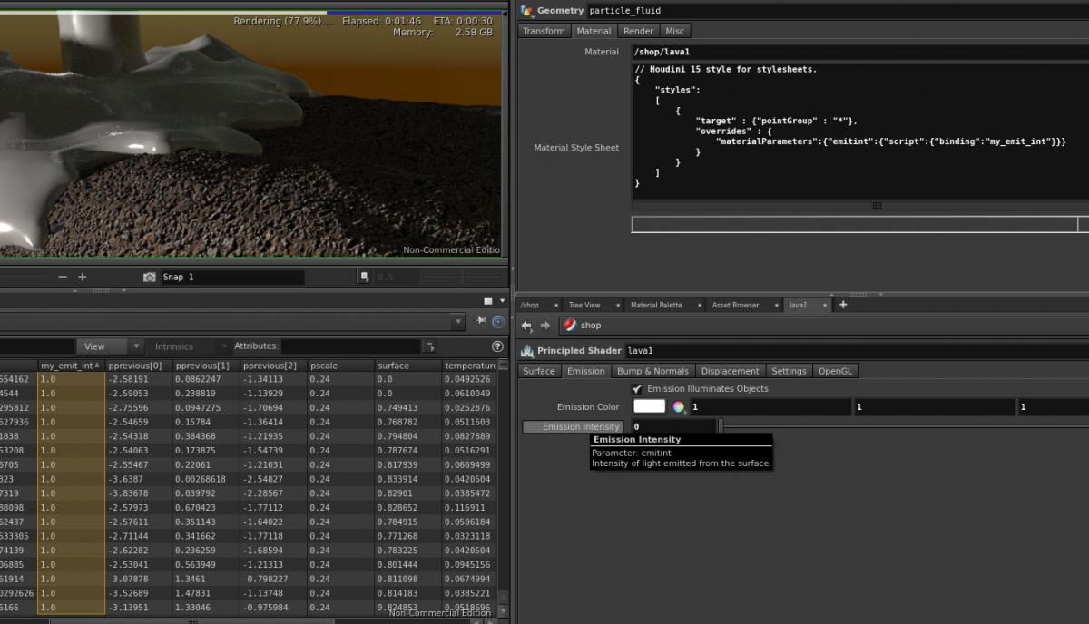

I have a simple lava setup where the lava flows over some obstacles. This works fine.
I am using the default lava1 shader that was generated by the shelf tools.
I have created a new attribute on the points called my_emit_int and set it to the value of 1.0.
I have manually set the emitint for the lava1 shader to 0.0. Thus the grey matte look of the fluid.
I am using the following stylesheet code to override the exiting emitint with my_emit_int.
// Houdini 15 style for stylesheets.
    "styles":
            "target" : {"pointGroup" : "*"},
            "overrides" : {
                "materialParameters":{"emitint":{"script":{"binding":"my_emit_int"}}}
This stylesheet code produces no errors when rendering but it also does not work. my_emit_int attribute should take over the emitint value and set it to 1.0. This is not happening.
What is the syntax for the stylesheet that I should use to successfully override a material parameter with an attribute?
