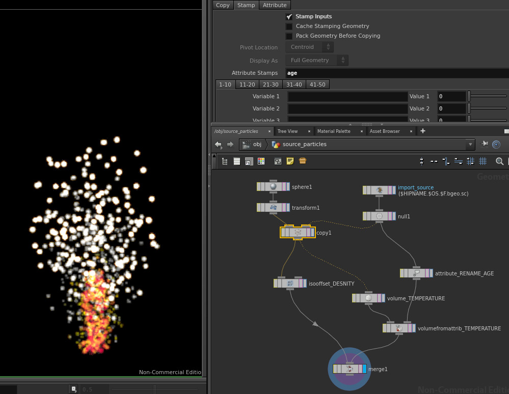

What about something like this...
Copy a sphere onto the particle points and scale them by age.
Then create a fog volume out of that surface geometry, this becomes the density value for the shader.
Next create a new volume from that same geometry and name it temperature.
From the original points rename the age attribute to temperature.
Now that you have a matching volume name and attribute name you can use a VolumeFromAttribute node to create the temperature field.
Merge the density and temperature volumes together and you have output that the BillowySmoke shader can make use of.

Hey Atom,
Again, I appreciate the help.  I went through the file and got it to work, but is not exactly the route I am looking for.  Although it is still a very useful lesson I didn't know on creating attributes in volumes and such.  So it is still a helpful file I will keep to refer to as I continue learning Houdini.

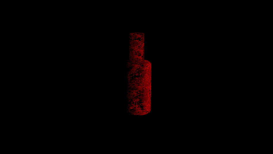

What I probably should have stated in my first post to make it more clear on what I am aiming for is that I have a pyrosolver already working.  The smoke is being emitted from a different set of particles (image01 below)

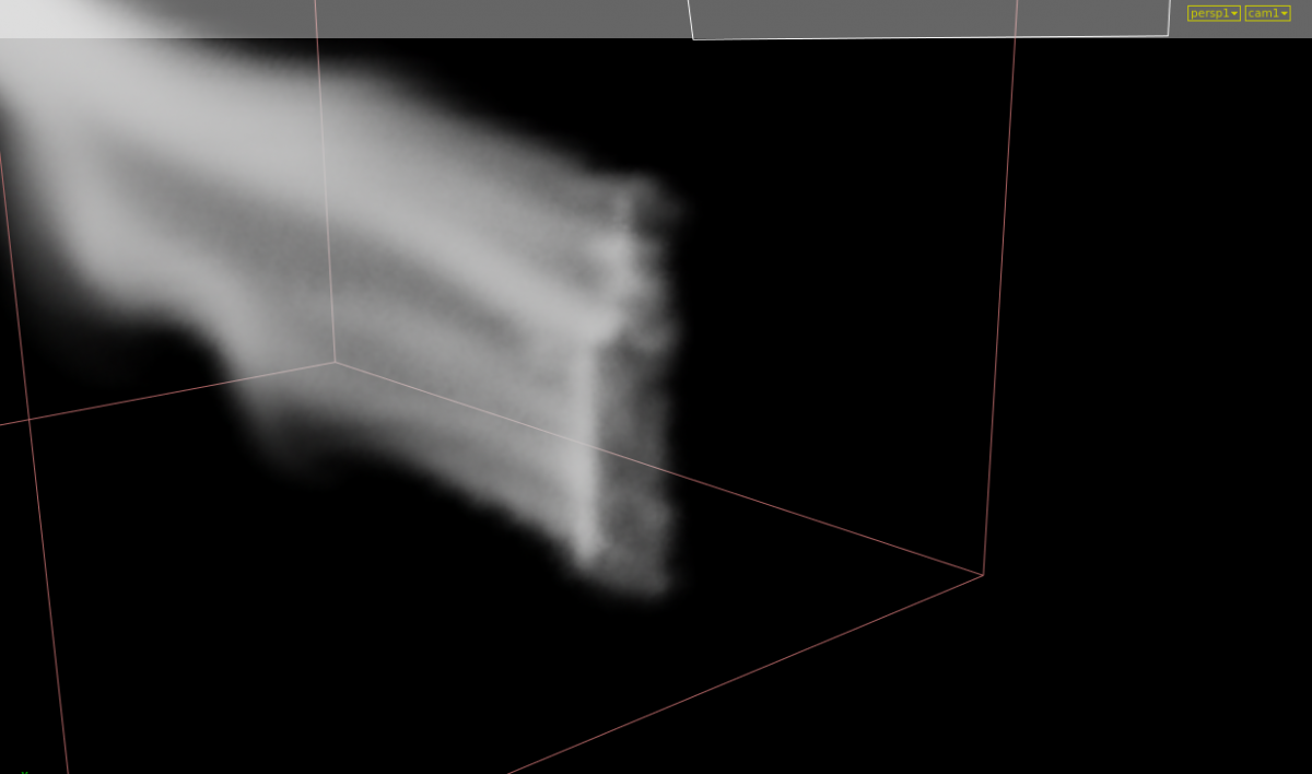

and I want to implement age into that smoke. (image 02)
post-15049-0-21640800-1454978084_thumb.p
That way I can create a similar color effect to the particles in the image of the first post.
