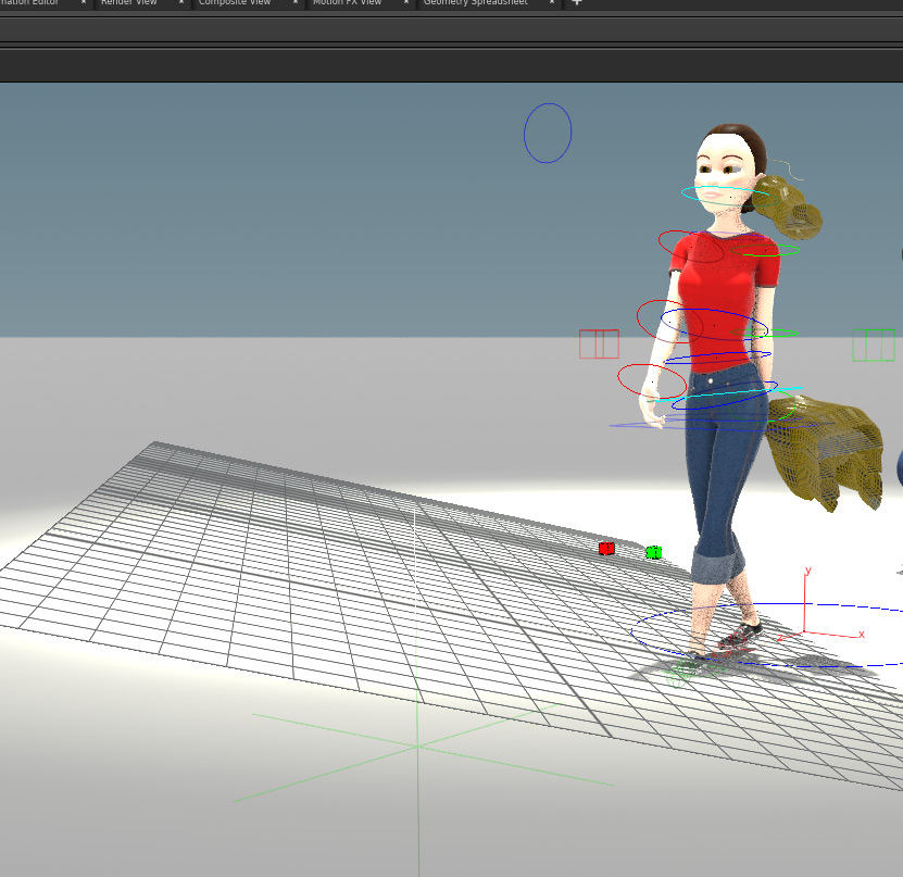

Atom Posted May 15, 2016 Share Posted May 15, 2016 (edited) Hi All, Can anyone tell me why the construction grid would go out of alignment? Is there a reset construction grid rotation button somewhere? I don't even know how I rotated the construction grid in the first place? What tool would I use for that? Edited May 15, 2016 by Atom Quote Link to comment Share on other sites More sharing options...
Guest tar Posted May 15, 2016 Share Posted May 15, 2016 Top of viewport -> perp1/Set Construction Plane/Revert to Defaults. Quote Link to comment Share on other sites More sharing options...
Atom Posted May 15, 2016 Author Share Posted May 15, 2016 Ah, thank you. Also deleting that viewport and creating a new one also works. Quote Link to comment Share on other sites More sharing options...
