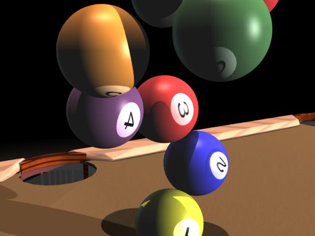

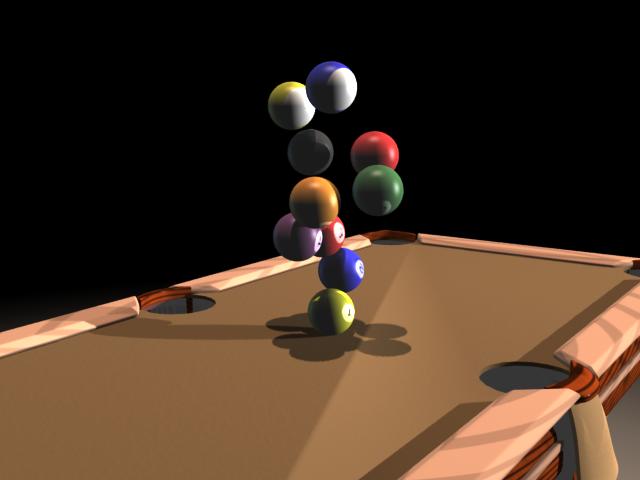

Pearl Posted April 6, 2006 Share Posted April 6, 2006 Hi, I'm a new Houdini user and a first time poster. I'm currently in Vancouver Film School's new Houdini program. As a class assignment, we were told to model a complete pool table set. As part of that, I'm making a shader for the pool balls. So far, I can get my shader to make the ball either striped or whole-colored based on the number input paramater. I can also get the correct number of the ball onto it, but I'm relying on 15 different textures. So, my question is... Is there a way to take an input parameter to a shader, create a corresponding font in COPs, and then feed it back into VOPs? I know how to use pic() to bring COPs info into SOPs, using the UVTexture SOP. I just don't know what parameters to put inside my VOP network to get the proper projection. Any help would be greatly appreciated. I apologize for the long-winded description. Thanks! Quote Link to comment Share on other sites More sharing options...
