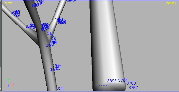

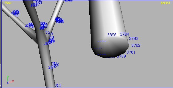

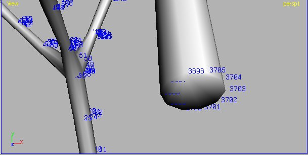

I am "still" having problems with polywire sop
- I have an animated l-system and polywire is a good solution to create a geometry. however the point numbers keeps changing in every single frame due to the animation which prevents getting a proper UV map
The Question is How can I keep the point numbers same in every frame.
(I tried to create a static geometry and transfer and override its point numbers with the animated one but I couldn't manage to do this)
Any Ideas Suggestions - Help !!!
cheers
Frame_1 Frame_5 Frame_13
post-1831-1186161178_thumb.jpg post-1831-1186161182_thumb.jpg post-1831-1186161187_thumb.jpg

Hi eetu
thanx for the suggestions.
the thing is that the geometry is l-systems so it is actually really complex. sort sop cannot manage to keep them constant. well it keeps some of them but not all of m depending on the complexity.
And for the UVs;; Polywire creates UVs automatically which I couldnt manage to edit as I wished. So my problem is I have a procedural shader that I have created in VOPs and I want to use the point positions of the polywired tree geometry (instead of using the UVs that are automatically created). But the problem is I couldnt find a way to keep them constant so my shader became useless in this situation.
