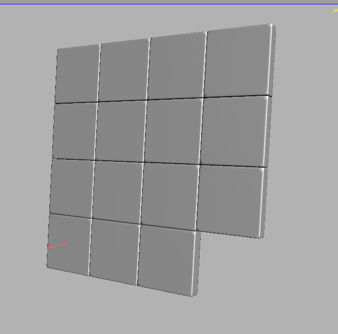

Hello everybody,
I want to create a "scramble game" effect, even with more tiles than the ones I show here.
How would you guys go about it? Hand animate it it's a bit out of the question if I'll multiply the number of tiles...
Thank you in advance.

Nice problem! Here's a solution using the SOP solver - it just slides a random piece each time. ...and it's not very elegant.

slide.hip
Thanks Stabby!
It looks really cool, and I'll definitely keep this hip file for reference.
Altough it's very hard for me to understand it, I hope I can take some ideas from it. :P
