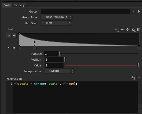

In a wrangle after the pop sim you can just add an attribute wrangle and do this. f@nage (same as this btw f@age/f@life) is a built in attribute that it gives you a normalize value between 0 - 1 which is nice for remapping, f@pscale for example or other attributes
You could also use the attribute adjust float nodes as well.
