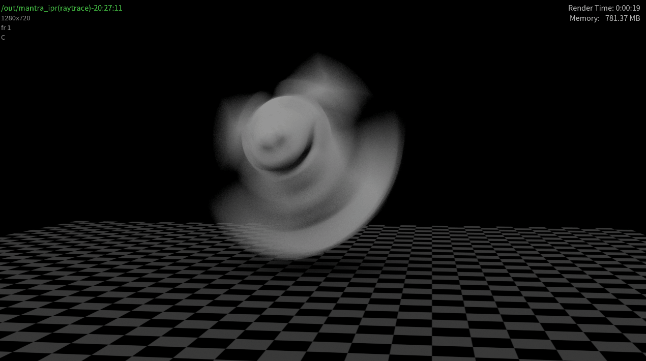

sipi Posted May 30 Share Posted May 30 Maybe animate the geo or volume on subframes using simple modulo expression? frozen_motionblur.hiplc (hate to put pighead in such a vulnerable situation) 1 Quote Link to comment Share on other sites More sharing options...
Lucavfx Posted June 1 Author Share Posted June 1 This is perfect, thank you! Quote Link to comment Share on other sites More sharing options...
