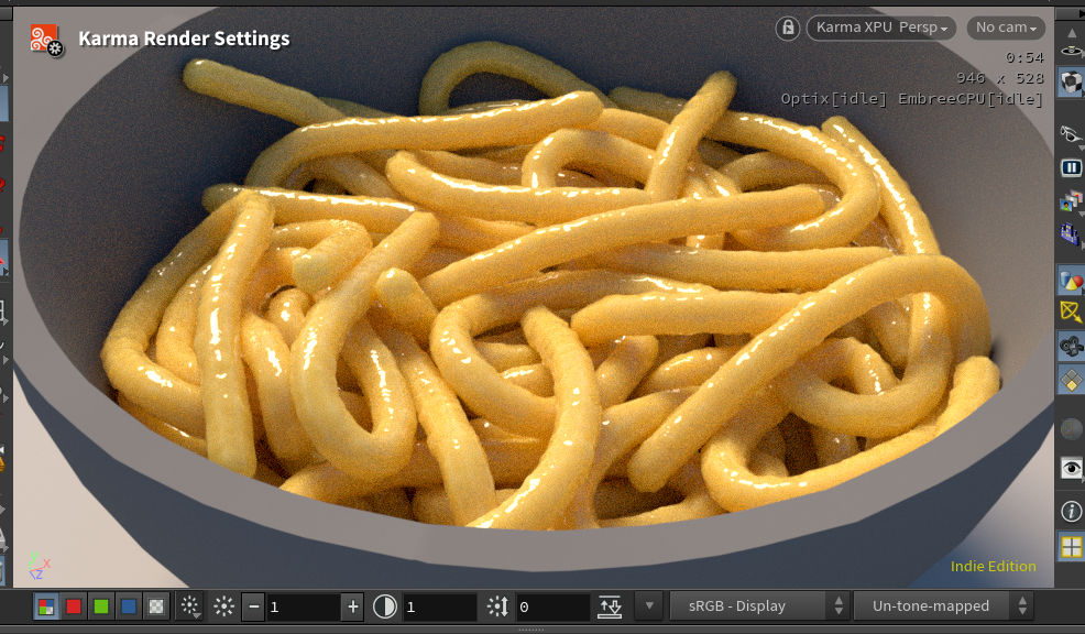

This is what I have so far:
What do you think about it? Is it working? How to improve?
I have limited experience with shading and rendering and lighting. Here i'm using displacement to get the variation in the reflection. Is it a good idea? Is it the way? Or are there smarter/faster solutions?
Any kind of feedback is much appreciated. Feel free to play the supervisor here ;)
pasta_shader.hiplc

A couple things I see at first glance:
1. Make sure to subdivide the tubes, noodles. Add more detail in the bends so the curves are smoother.
2. Make them thinner.
3. Perhaps more subsurface scattering?
Nice work, though. This is a great start.
