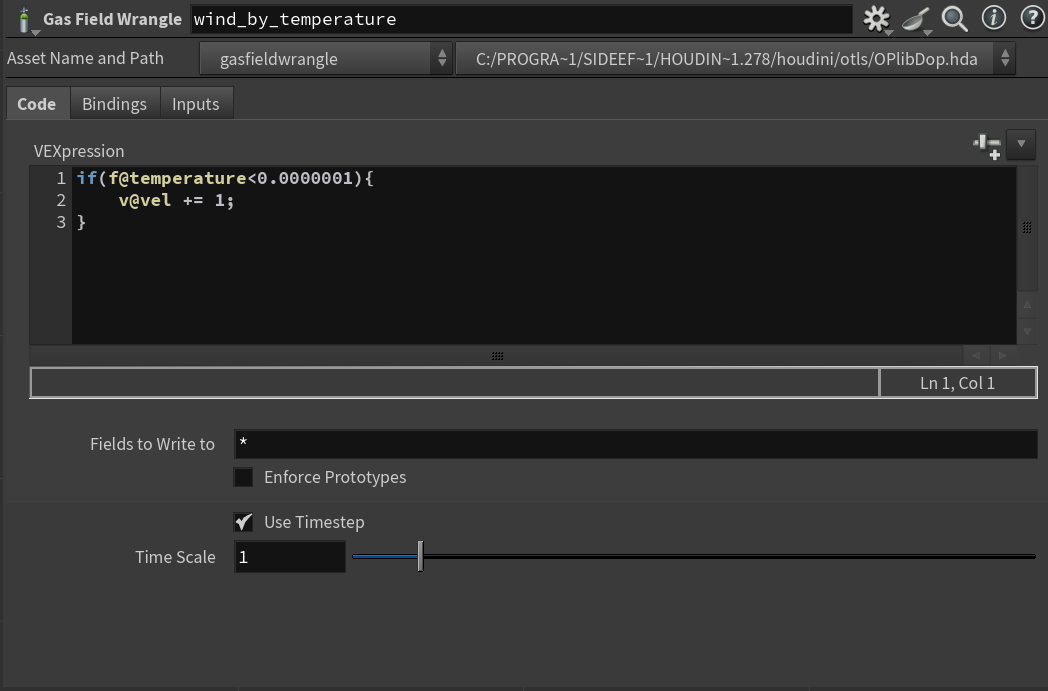

I'm trying to add wind that affect only the voxels with low temperature but for some reasons it's not working.
Here the HIP FILE wind.hipnc
I feel like the attribute @temperature is not recognized inside the dop network in a gas field wrangle.

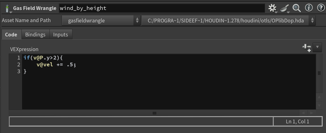

I did the same thing but with the height in Y and it's working. The gas Field Wrangle can read the P attribute and the Vel.
When the smoke reach 2 meters height it got affected by the force.
If I do that with the temperature, as it's not read the attribute is equal to zero so even with a very low value the force will be applied...

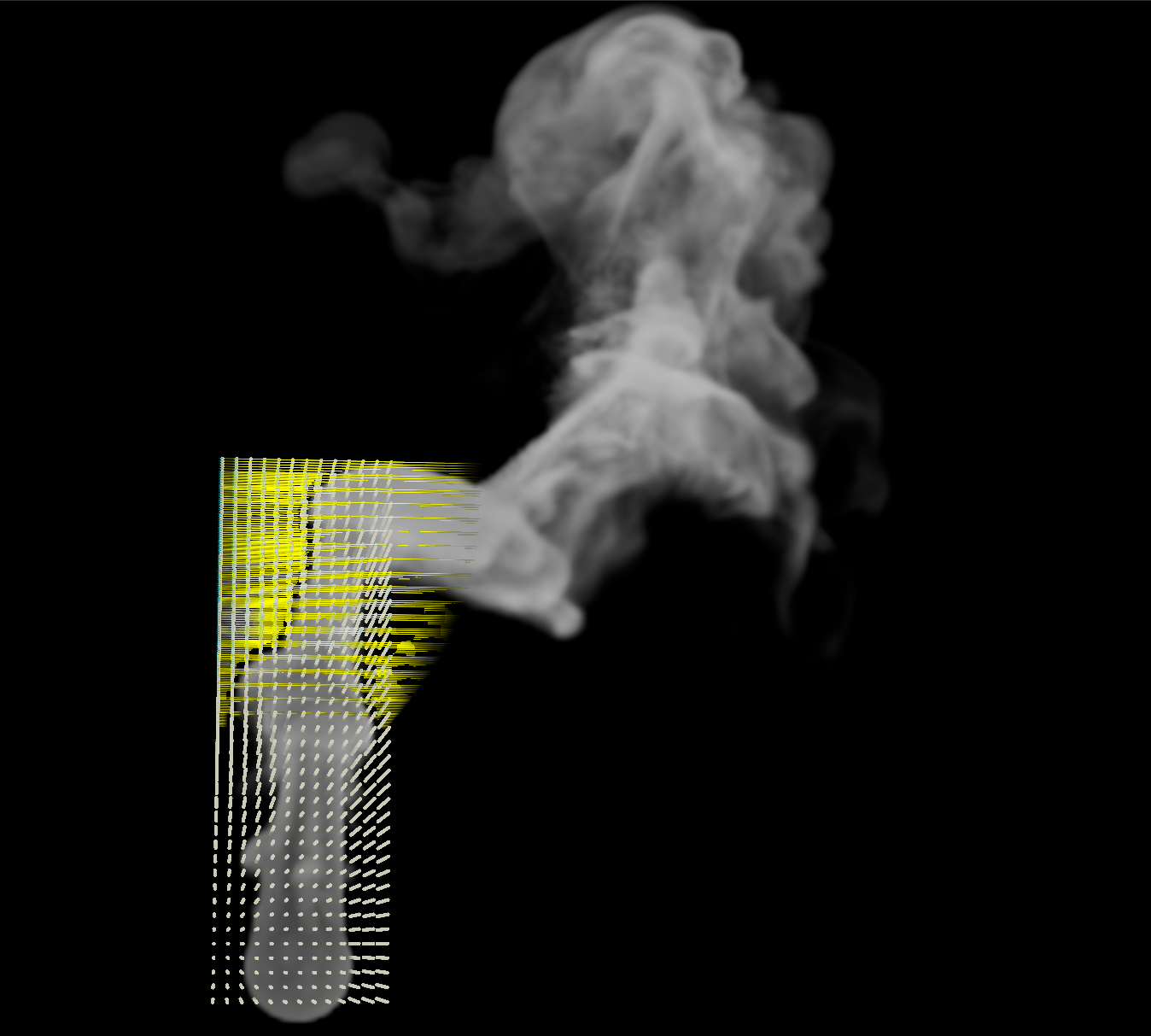

So I managed to do that with a custom vel field (I scattered points with v attribute that goes on the side and I rasterize it in volume) but it may be heavy on larger sim so I'm trying to find a way to use directly the temperature if that's possible.

That's odd. Your example file works for me unchanged. One thing to remember, is once you dive inside the DOPNet, your f@temperature point attribute no longer exists. It becomes voxel data. Try removing the f and just reference @temperature.
Try this code. in your gas wrangle. This is actually a cure for mushrooming velocity.
@vel *= @temperature;
