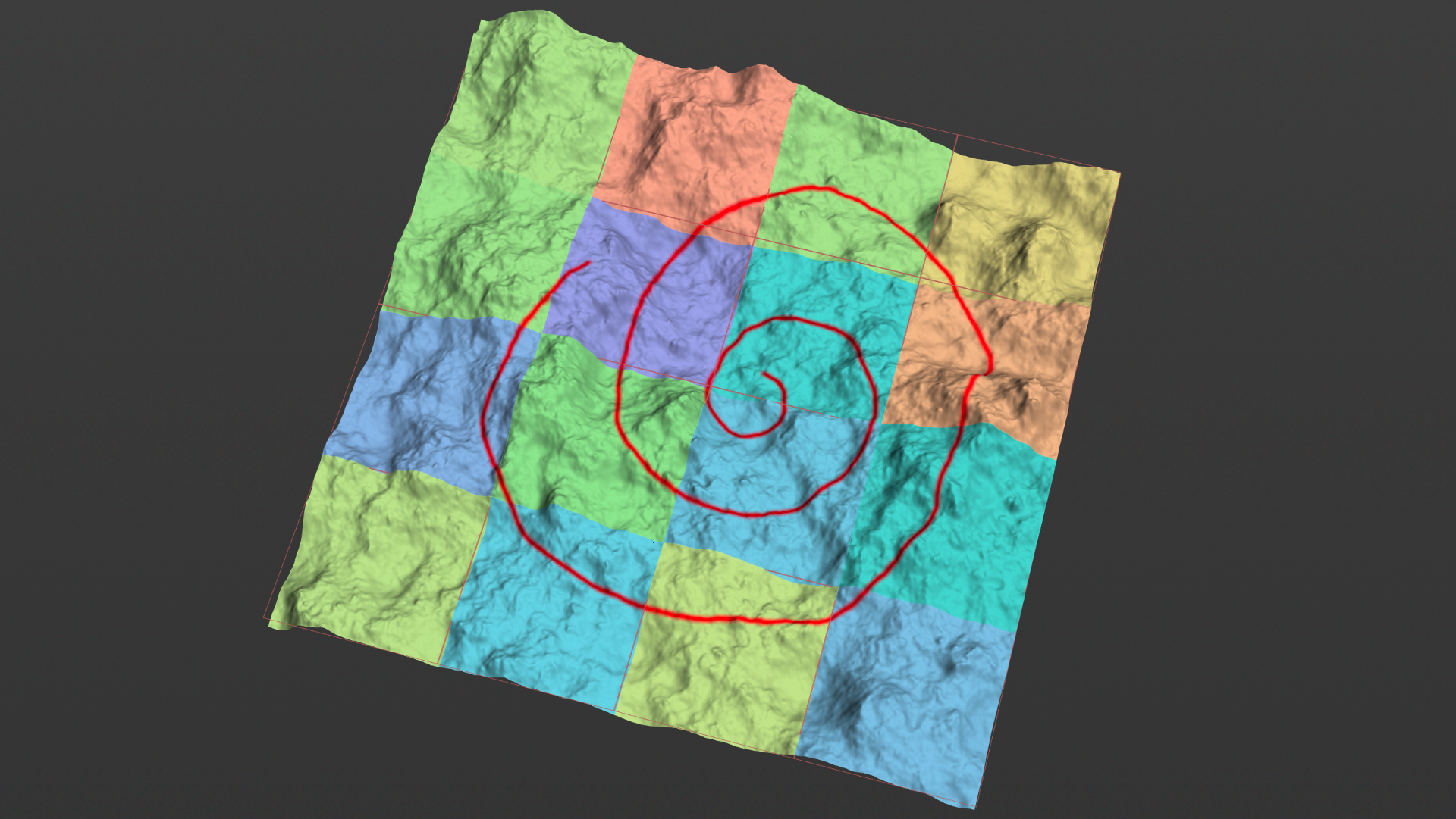

revelationsr Posted December 13, 2025 Share Posted December 13, 2025 I would like to create a large scale terrain using height fields. Something that is too big to be done in just one chunk. I have been going over different ideas on how to go about doing this but then I end up at a road block at some point. Something I either cant, in the moment, think of a way around or might need something that I am unaware of yet. What I would like to have is a large low rez height field. Here I want to put in the basic rough terrain. Just a "block in". Then that large terrain is spilt up into 10x10 chunks. Up until here I dont have a problem. What I would like to do is to select several of these chunks and use a heightfield paint to paint across them. How ever only the first chuck will be painted on. Any thoughts on how to change this? Quote Link to comment Share on other sites More sharing options...
konstantin magnus Posted December 14, 2025 Share Posted December 14, 2025 Hi rev, you could paint on the large terrain and transfer its mask to the smaller tiles using a volume wrangle. write_mult_volumes.hip Quote Link to comment Share on other sites More sharing options...
