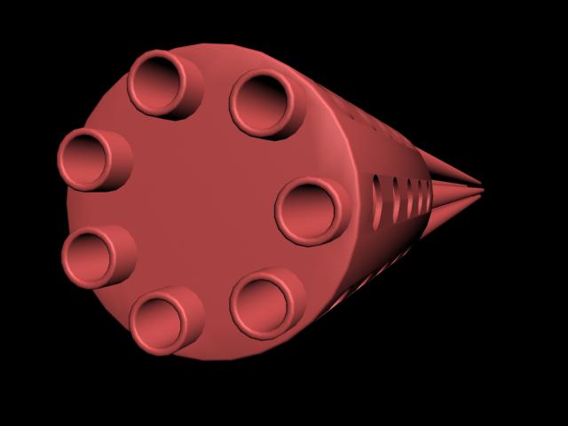

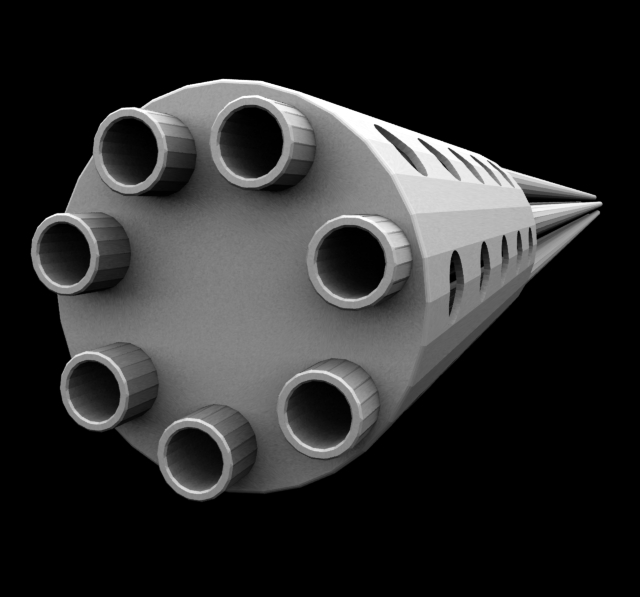

Barad-Dur Posted December 6, 2008 Share Posted December 6, 2008 Hi guys, I am using 3DSMax 9 (64 bit) to create geometry and am importing that geometry into H9.5. That part is working very well. My question is this: Is there a node in Houdini that acts like the "Smooting Groups" function in 3DSMax? That would be a polygon property as far as Max is concerned. I have attached renders from both Houdini and Max showing the difference. Any help would be most appreciated. Thank you. David Quote Link to comment Share on other sites More sharing options...
kumpa Posted December 6, 2008 Share Posted December 6, 2008 Facet SOP is what you are looking for, set cusp angle to 20 degrees or so. Quote Link to comment Share on other sites More sharing options...
Barad-Dur Posted December 6, 2008 Author Share Posted December 6, 2008 AWSOME! Thank you Kumpa! That was exactly what I was looking for. Quote Link to comment Share on other sites More sharing options...
