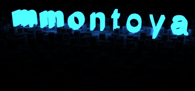

eetu Posted September 9, 2009 Share Posted September 9, 2009 With PBR it's really quite easy. Use a shader that has emission set up (or export Ce in your own), and set a diffuse limit of at least one. glow_mmontoya.hipnc Quote Link to comment Share on other sites More sharing options...
mmontoya Posted September 9, 2009 Author Share Posted September 9, 2009 With PBR it's really quite easy. Use a shader that has emission set up (or export Ce in your own), and set a diffuse limit of at least one. Thank you - that's exactly what I was looking for! I really appreciate your taking the time to provide a scene file for me as well. Quote Link to comment Share on other sites More sharing options...
