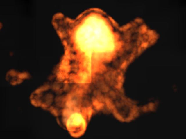

tp- Posted October 12, 2009 Author Share Posted October 12, 2009 Hello, looks like a lot of fuel emission, and poor simulation quality, maybe if you add more voxels to the container can improve the sim, animate the fuel simulation too, and try to add more substeps to the simulation. Thanks, I'm worried about adding more voxels though because I left low quality pyro running over the weekend and it got up to frame 17 by Monday :S Thats with 65 uniform divisions. I've scaled down the size of the container, I presume this will have the same effect as increasing the voxel count but without the gain in calculation time...? I'll give animating the fuel a go, cheers for the heads up. try adding point velocities to your shards in sops ( just use the normals even) and turn on Point Velocity under the Advanced tab. That way you can have total control over the initial velocities of your source. Oh yea , and you need way more divisions in that pyro container Cool, this sounds like what I need, I'll let you know how I get on. Next problem: odd squares in the render again. I turned on smoke and this happened: Quote Link to comment Share on other sites More sharing options...
