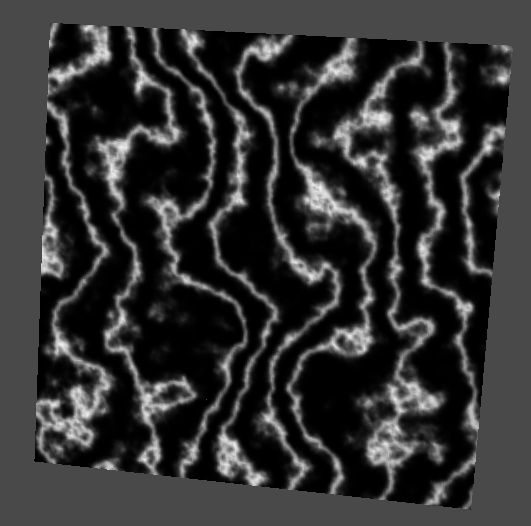

CSN0309 Posted May 17, 2010 Share Posted May 17, 2010 hi~guys Has anybody know how to make this kind of "noise" map in houdini? like a bundle of traces on the surface any ideas? thanks Quote Link to comment Share on other sites More sharing options...
Fabiano Berlim Posted May 17, 2010 Share Posted May 17, 2010 hi~guys Has anybody know how to make this kind of "noise" map in houdini? like a bundle of traces on the surface any ideas? thanks You can use the pattern Veins. Of course to get a natural texture like that you need to mix several noises. Cheers Quote Link to comment Share on other sites More sharing options...
CSN0309 Posted May 17, 2010 Author Share Posted May 17, 2010 thank you~ let me try it Quote Link to comment Share on other sites More sharing options...
DaJuice Posted May 18, 2010 Share Posted May 18, 2010 Look into the UVNoise VOP. It can make regular shapes like boxes and stripes look very erratic. Quote Link to comment Share on other sites More sharing options...
