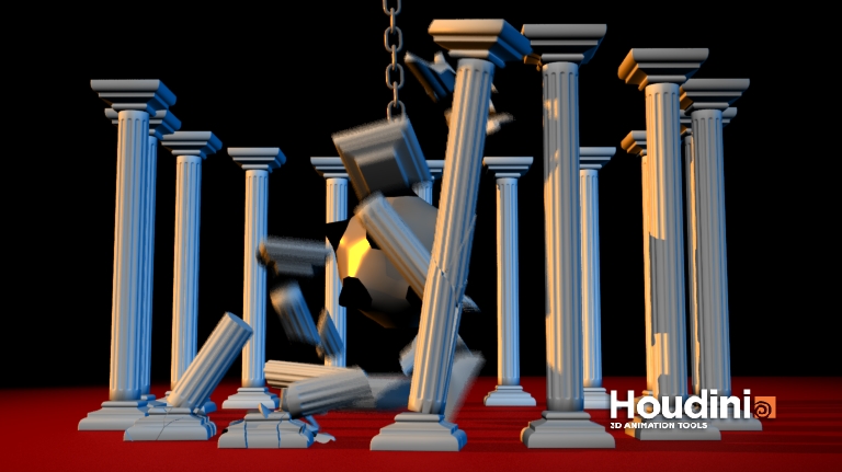

I did the smashing columns sequence without trouble, then I decide to move on creating a smashing ball linked to a chain: to obtain a faster result, I decided to not have a rigid simulation of the chain and for the ball I used the platonic SOP whit "Soccer Ball" selected and some extrusion.
Now!
Two things are making me crazy:
1. The soccer ball has some part black and some white, even if I use a Point SOP to take all vertices with same color and applying a material, the black parts are still visible in redering as image shows you
2. There's no blur on the smashing ball like columns have normally.

Just had a quick look at the file. Seems like the black parts remain since when you make a platonic soccer ball it creates a primitive attribute for Cd, thus even when you change it on a point sop it wont change on the render. So you could either delete that attribute, promote it the point level or override it with another primitive sop maybe.

I solved the black color of the ball just watching the third lesson:
1. the ball goes to a COLOR SOP with constant color <1,1,1> to primitives
2. then a MATERIAL SOP takes the shader and overrides local variables for the paramater BASECOLOR where I put <$CR,$CG,$CB>
The problem of motion blur still remains! :/
