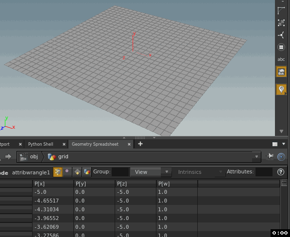

mestela Posted August 4, 2015 Share Posted August 4, 2015 (edited) Ahhh, cool trick! I knew you could get group membership in vex with @group_mygroupname, I didn't know you could set it that way too. Eg, group all points with ptnum greater than a slider threshold: if (@ptnum>chi('threshold')) { i@group_mygroup=1;} To get visual feedback, hit '9' in the viewport (or click the 'display group and attribute list' button on the right toolbar of the viewport, towards the bottom), and make sure its in a mode that matches your wrangle mode. Animated gif (click to play) Edited August 4, 2015 by mestela 2 Quote Link to comment Share on other sites More sharing options...
