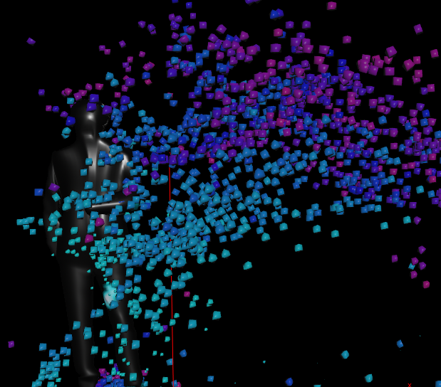

Keshaw singh Posted January 29, 2016 Share Posted January 29, 2016 hi guys i made simple particle animation and copy that particle to box geometry and now m trying to render box with motion blure its not working . also mantra motion blur is on and attached that scene file snapshot need help ASAP Quote Link to comment Share on other sites More sharing options...
Atom Posted January 30, 2016 Share Posted January 30, 2016 (edited) You need to add a trail sop to the object that contains the particles and set it to compute velocity. Then go up one level and under the Render TAB under Sampling activate Geometry Velocity Blue. Overview: 1.) Activate Velocity Blur on Object. 2.) Turn on Motion Blur in Mantra Node. 3.) Make sure your object is generating velocity attribute (particles probably are, otherwise add a Trail SOP to compute velocity from motion). Edited January 30, 2016 by Atom Quote Link to comment Share on other sites More sharing options...
fathom Posted January 30, 2016 Share Posted January 30, 2016 particles should have velocity, but a copy won't push the velocities onto the copied geo unless you activate it. there is a tab (attributes, i think) on the copy sop that lets your enable the transfer of attributes form your template geo onto your copied geo. normally it's disabled. the defaults rules should work fine for you. Quote Link to comment Share on other sites More sharing options...
