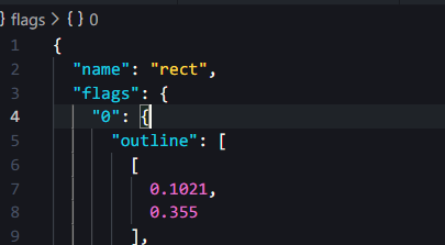

esoids Posted Monday at 07:27 PM Share Posted Monday at 07:27 PM Is this still working in H21? I can't seem to find a working combination. Quote Link to comment Share on other sites More sharing options...
animatrix Posted Tuesday at 08:20 AM Share Posted Tuesday at 08:20 AM 12 hours ago, esoids said: Is this still working in H21? I can't seem to find a working combination. Yes if you have custom node shapes under HOUDINI_USER_PATH/config/NodeShapes Then it will work. Make sure to turn off "Use Custom Shapes" Quote Link to comment Share on other sites More sharing options...
esoids Posted Tuesday at 09:41 AM Share Posted Tuesday at 09:41 AM 1 hour ago, animatrix said: Yes if you have custom node shapes under HOUDINI_USER_PATH/config/NodeShapes Then it will work. Make sure to turn off "Use Custom Shapes" Thanks! This is very weird. I deleted my pref folder. I added only Documents\houdini21.0\config\NodeShapes where I copied the bone.json and renamed it to rect.json. Then turned off Use Custom Shapes. This is the result: It uses the default rectangle but not the shape I put there. Quote Link to comment Share on other sites More sharing options...
animatrix Posted yesterday at 05:51 AM Share Posted yesterday at 05:51 AM But the shapes you copied has to match existing ones by name like rect while looking like a circle. Did you do that? Quote Link to comment Share on other sites More sharing options...
esoids Posted yesterday at 03:53 PM Share Posted yesterday at 03:53 PM 9 hours ago, animatrix said: But the shapes you copied has to match existing ones by name like rect while looking like a circle. Did you do that? Yes, I copied circle, bone etc and renamed them to rect.json in the user folder. But they all show up as the standard rectangle like in the screenshot. So again just to remain sane: I went into the Houdini install folder, copied different jsons (like bone, circle) to Documents\houdini21.0\config\NodeShapes and renamed them to rect.json just to test. But they all render like the standard rectangle shape in Houdini (round corners). Am I missing something here? Quote Link to comment Share on other sites More sharing options...

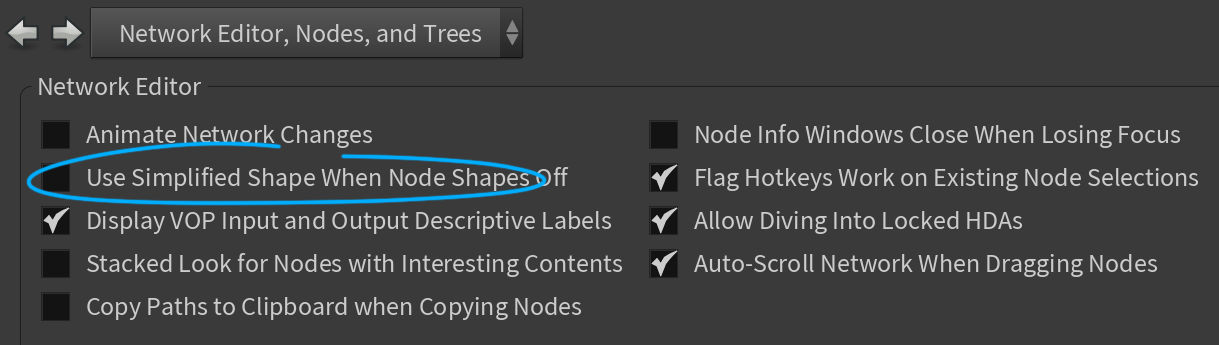

animatrix Posted yesterday at 05:27 PM Share Posted yesterday at 05:27 PM Did you also turn this option off? Quote Link to comment Share on other sites More sharing options...
esoids Posted 22 hours ago Share Posted 22 hours ago 2 hours ago, animatrix said: Did you also turn this option off? Yes, it is off. Desperately installing latest daily. Maybe it's something off in the install or something. I'm using Education version, do you think that has anything to do with it? Installed through the launcher. Quote Link to comment Share on other sites More sharing options...
esoids Posted 22 hours ago Share Posted 22 hours ago Omg... you need to edit the name INSIDE the json. Quote Link to comment Share on other sites More sharing options...
animatrix Posted 6 hours ago Share Posted 6 hours ago 16 hours ago, esoids said: Omg... you need to edit the name INSIDE the json. Oh yes I forgot to mention this because I created my own circle shape and called it rect to override the default rect node shapes. Quote Link to comment Share on other sites More sharing options...
