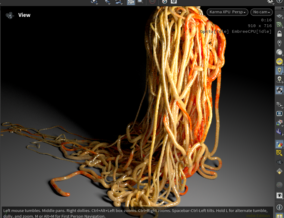

sipi Posted April 19, 2025 Share Posted April 19, 2025 I'm working on a pasta monster as a personal project. How would you create sticky, stretchy, melted cheese on this: Quote Link to comment Share on other sites More sharing options...

sipi Posted April 21, 2025 Author Share Posted April 21, 2025 1 hour ago, tamagochy said: Vellum fluids should do this trick Yeah, vellum is the key here. I'm testing several vellum options. If anyone is interested, I will post the hip here once it's ready... Flip based sauce (not quite right at some places) vellum hair based cheese another vellum hair starting point here the sauce simply comes from the shader 1 Quote Link to comment Share on other sites More sharing options...
sipi Posted April 21, 2025 Author Share Posted April 21, 2025 Using glue constraints and meshing the constraint geometry is perfect for melted cheese! glue_constraint_cheese.hiplc 3 1 Quote Link to comment Share on other sites More sharing options...
sipi Posted April 26, 2025 Author Share Posted April 26, 2025 I'm on the way to create cheese onto the pasta monster. Can someone tell me: 1. is it possible to break vellum hair in a way that it doesn't produce those tiny fragments? 2. how to handle if the collision goes through a pinned point, because as you can see there is this long red line? vellumhair_cheese_v001.hiplc 1 Quote Link to comment Share on other sites More sharing options...
sipi Posted May 1, 2025 Author Share Posted May 1, 2025 (edited) Ok, it's done. Have fun with the hip! (made in 20.5.550) pasta_monster_with_cheese.hiplc NOTE: you'll need qLib and LABS, because the setup uses the Noise ql SOP in some places, and the Boolean Curve LABS SOP at one place. Worth to mention, the setup uses these techniques from Konstantin Magnus: https://procegen.konstantinmagnus.de/wires-connecting-objects https://procegen.konstantinmagnus.de/filling-a-mesh-with-curves Check out his works! Amazing! https://www.youtube.com/@KonstantinMagnus This pasta thing is gonna be a short film actually Edited May 1, 2025 by sipi 1 Quote Link to comment Share on other sites More sharing options...
