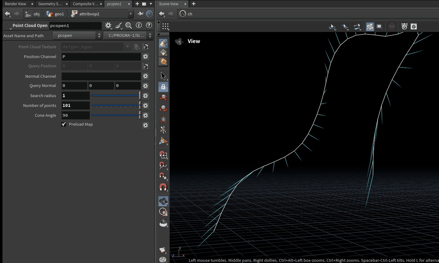

avoid_force_super_simple.hip thats maybe simpler

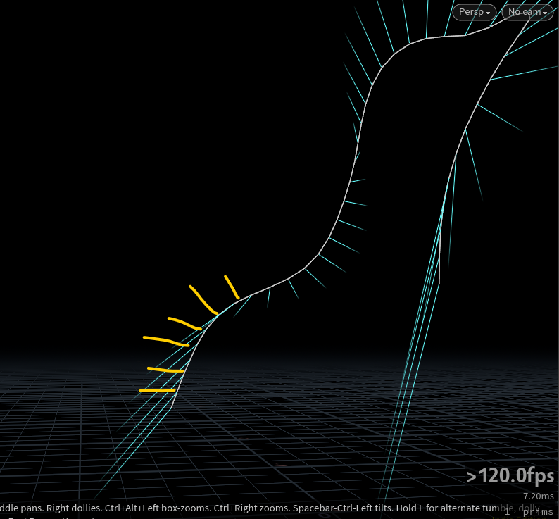

interesting one,
though it doesn't seems to be 100% correct
for example here the normals don't follow the curvature properly
adjusting the Search Radius can help, but it has to be larger than the length of a segment in the line (this can be problematic if the distribution of points are not uniform in the line (and if you can't apply resample for some reason))
but thanks, it's an interesting and simple approach indeed.

interesting one,
true i think then your setup is already good and simple to use.  you could also extend the curves to fix the issue in my setup ... but guess thats then already too much :)
