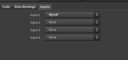

fencer Posted June 5, 2025 Share Posted June 5, 2025 30 minutes ago, revelationsr said: @Fencer. Thank you for the response. What I had originally is very close to what you have there. I put it in the setup and it is not working. I honestly dont know what I am missing. The scene bellow has the script above in it. In theory the cloth should rise up and when it gets about 1/4 of a meter away it should yank towards the animated geo. clothConstraintTest.hipnc 618.85 kB · 0 downloads Set wrangle input Geometrywrangle > Inputs > Input 1 > Myself Analyze data before choosing values and final multiplier. Quote Link to comment Share on other sites More sharing options...
revelationsr Posted June 5, 2025 Author Share Posted June 5, 2025 Input "myself" ! Well poopy. There is the missing piece of the puzzle. Thank you so much man! 1 Quote Link to comment Share on other sites More sharing options...

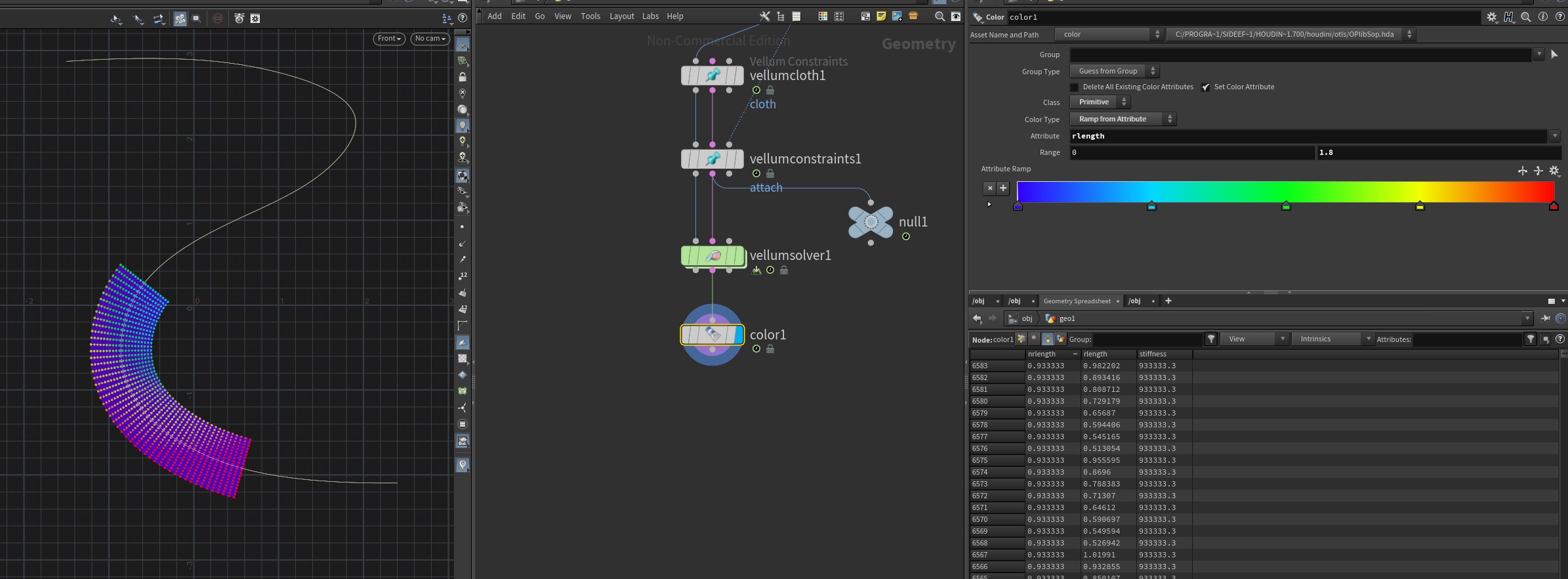

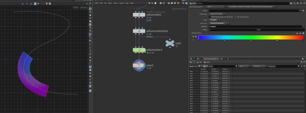

revelationsr Posted June 16, 2025 Author Share Posted June 16, 2025 Hello. I have noticed a problem with the setup. I assumed the script was working but after getting some odd results I realised there is something off. There is a "attach to geometry" constraint. The point of the script was that in the cloth sim it would take each constraint on each frame. Measure its distance from current cloth location to attached geometry. Then take that length and put it on a ramp to control that constraints stiffness. Example. Close = loose far = stiff I dont think the script is reading the 2 points Position that make up the constraint correctly. I noticed this when I plugged a color node to read the attribute "rlength" (the attribute that measures distance from point 0 to point 1). It was white ( meaning 1 ) constantly for everything until the happens to pass close the world centre (0,0,0). Then I would see black starting to appear on the points closest to world centre. This means that at least one of the two points are coming up 0,0,0. Any thoughts? clothConstraintTest.hipnc Quote Link to comment Share on other sites More sharing options...
revelationsr Posted June 17, 2025 Author Share Posted June 17, 2025 Solved. Thank you Quote Link to comment Share on other sites More sharing options...
