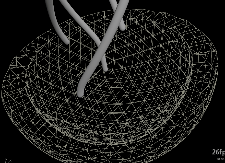

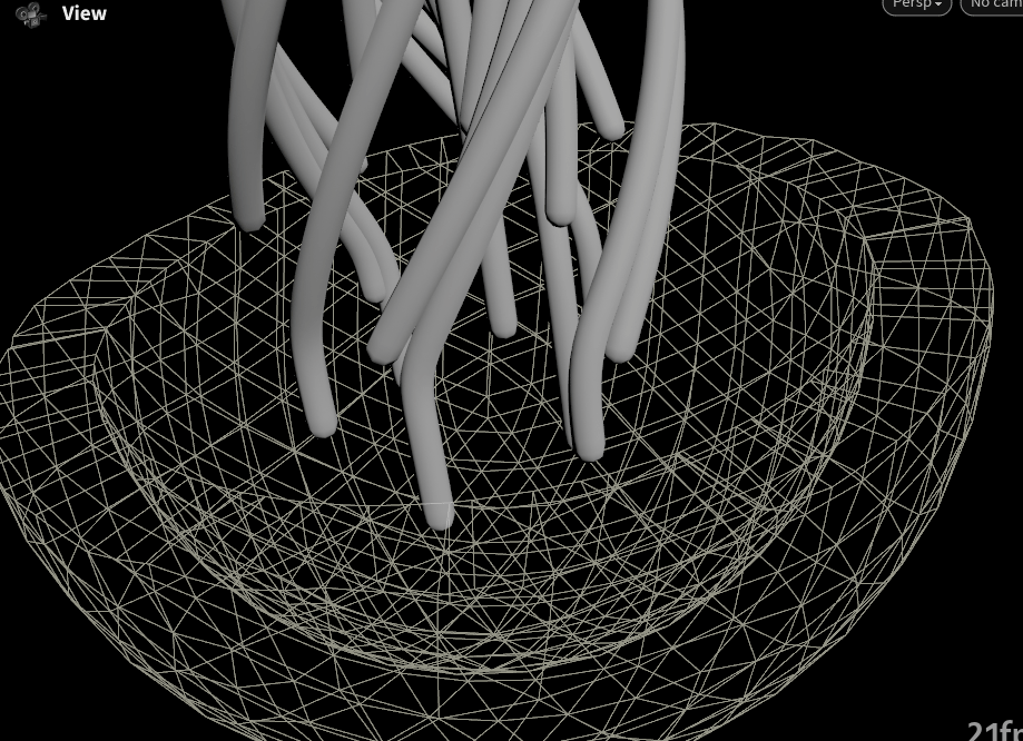

sipi Posted June 10 Share Posted June 10 I thought this would be easy, but no. Do you have any idea how to calm down this vellum hair sim? I tried constraint iterations, smoothing iterations, friction, substep, but can't relax them. (i would like to create a bowl of spaghetti, not worms ) restless_noodles.hiplc Quote Link to comment Share on other sites More sharing options...

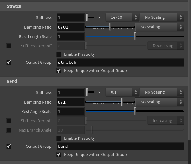

sipi Posted June 10 Author Share Posted June 10 Ha! Found it. Bend Stiffness and Damping Ratio is the key, and I also used 5 substep. 1 Quote Link to comment Share on other sites More sharing options...

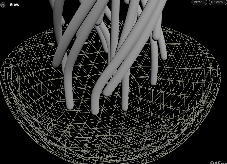

sipi Posted June 10 Author Share Posted June 10 Auto Sleep also helps: restless_noodles_v002.hiplc Quote Link to comment Share on other sites More sharing options...
hannes603 Posted June 11 Share Posted June 11 velocity damping in solver can also help. sometimes when too manny geo is falling ontop of each other, collision passes needs to be increased... i know now what i ll have for dinner Quote Link to comment Share on other sites More sharing options...
sipi Posted June 11 Author Share Posted June 11 9 minutes ago, hannes603 said: velocity damping in solver can also help. sometimes when too manny geo is falling ontop of each other, collision passes needs to be increased... i know now what i ll have for dinner I wanted to avoid vel damping because it affects how fast the pasta is falling as well, but yeah it can help. I was trying the collision passes but in this particular case it didn't change much. Would be interesting to check out a case when it makes a significant difference. Quote Link to comment Share on other sites More sharing options...
hannes603 Posted June 11 Share Posted June 11 (edited) collision_passes_100.mp4 collision_passes_10.mp4 col_passes_vellum.hip col passes 100 vs 10 jfyi Edited June 11 by hannes603 1 1 Quote Link to comment Share on other sites More sharing options...
sipi Posted June 11 Author Share Posted June 11 Wow!!! Thank you @hannes603 Quote Link to comment Share on other sites More sharing options...
